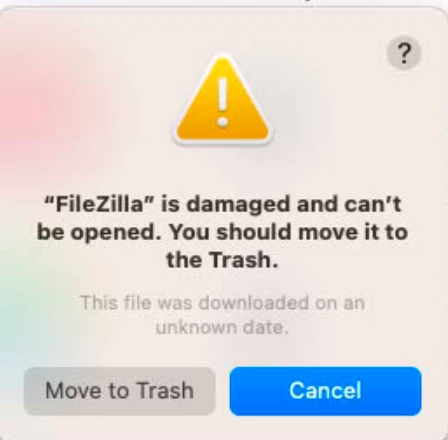

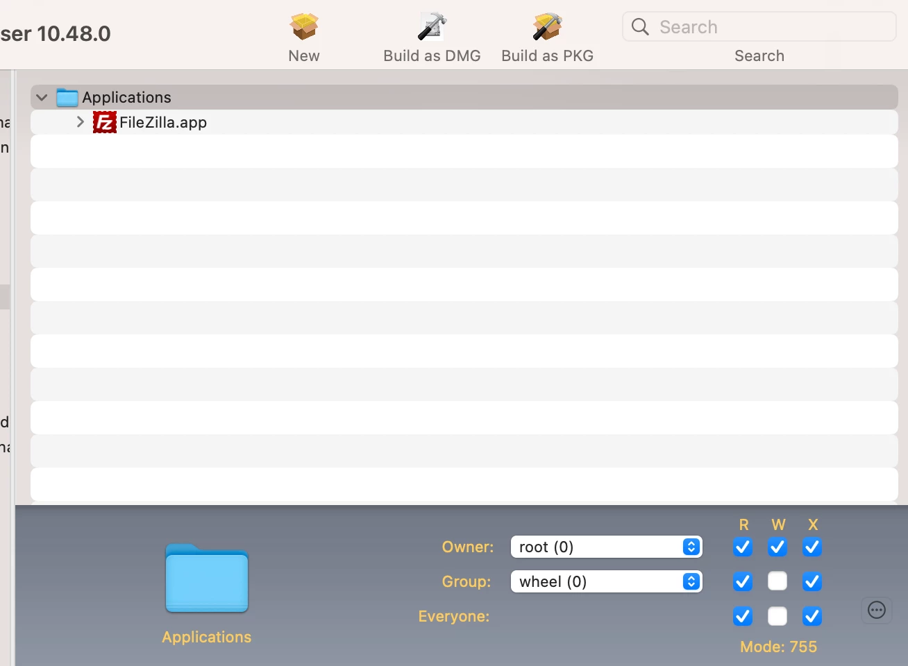

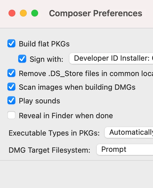

I am simply trying to repackage some drag and drop apps as flat packages using Composer. We do this so we can use them in our provisioning workflows via Jamf Pro.  Note: I have tried composer 10.44 to 10.48 and get the same results.
Using FileZilla as an example:
 That is pretty much it. No postinstall, but I am signing with my developer installer ID.
 I have tried to notarize and staple the .pkg's, but Apple does not like something in the .app file so I get "Invalid Package".
 I have tried all kinds of things to try and clear any security flag, but nothing seems to work.  The only thing that does work is control clicking and selecting Open, then open anyway.   That does not work when attempting to deploy to thousands of computers.  Our help desk will get overwhelmed with calls.
I have tried all of the following to fix the issue via script (kitchen sink from various how to's I found):
# disable gatekeeper sudo spctl --master-disable # The applications final destination, should always be used. problemApp='/Applications/Filezilla.app' # chown app to root sudo chown -R root:wheel $problemApp # chmod permissions to correct sudo chmod -R 755 $problemApp sudo chmod +x $problemApp # remove quarantine attribute sudo xattr -r -d com.apple.quarantine $problemApp sudo xattr -c $problemApp sudo xattr -cr $problemApp # touch the file sudo touch -m $problemApp # open the file sudo open $problemApp # enable gatekeeper sudo spctl --master-enable

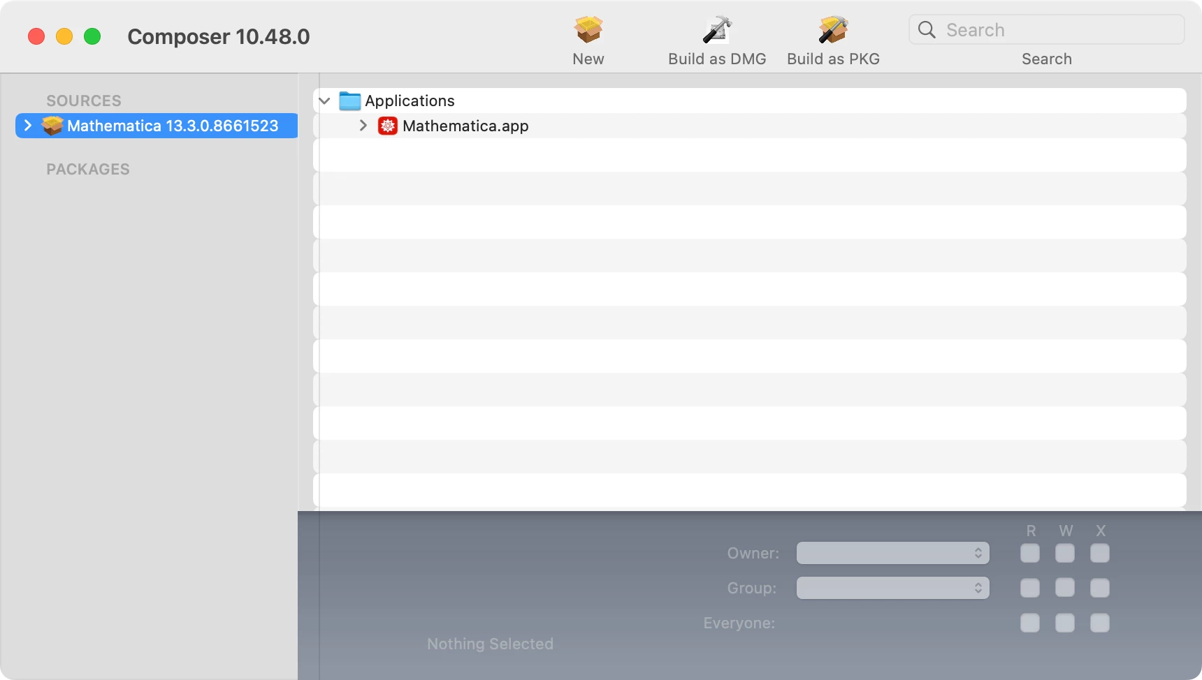

I have about a dozen drag and drop apps that I can no longer install via a pkg for redistribution on 13.4.1 because they all trigger a security flag and ask to be moved to the trash.  My biggest headache is Mathematica, which requires I insert a license file within the drag and drop .app for lab distribution.
Any advice?

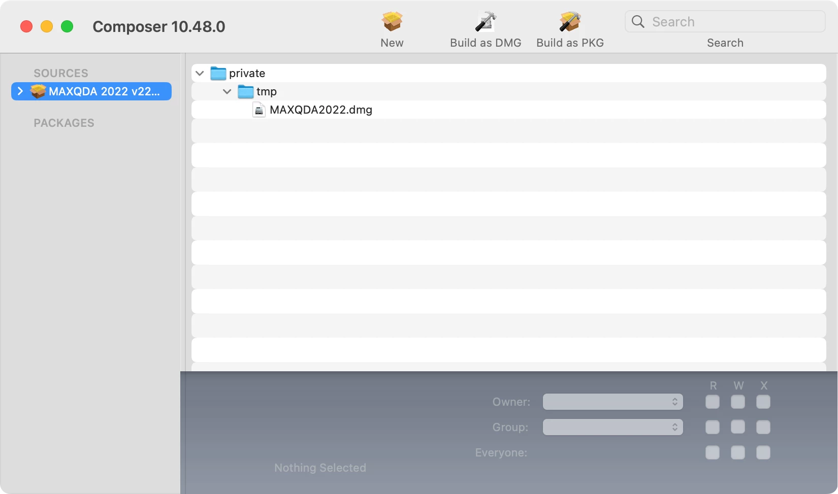

We got some apps behaving the same way (e.g. Metashape Pro, MAXQDA, OpenShot, VueScan Pro).
1) Install the original disk image (.dmg file) to /private/tmp:
2) Then copy the app to /Applications with a postinstall script:
#!/bin/zsh # Set Variables (manually) - please note: the (original) DMG file must be installed in /private/tmp appName="PRODUCT.app" dmgName="PRODUCT.dmg" volName="PRODUCT" ### Do not edit below ### # Unmount volume with the same name echo "\\nUnmounting volume '$volName', if available..." sudo hdiutil detach "/Volumes/$volName" echo "Done." # Open disk image & mount volume echo "\\nOpening '$dmgName' & (invisibly) mounting '$volName'..." sudo hdiutil attach "/private/tmp/$dmgName" -nobrowse -noverify echo "Done." # Copy app from volume to applications directory echo "\\nCopying '$appName' from '$volName' to '/Applications'..." sudo cp -Rp "/Volumes/$volName/$appName" "/Applications/$appName" echo "Done." # Apply correct owner & group to app file echo "\\nApplying correct owner & group to '$appName'..." sudo chown -R root:admin "/Applications/$appName" echo "Done." # Remove quarantine flags from app file echo "\\nRemoving quarantine flag from '$appName'..." sudo xattr -r -d com.apple.quarantine "/Applications/$appName" echo "Done." # Unmount volume echo "\\nUnmounting volume '$volName'..." sudo hdiutil detach "/Volumes/$volName" echo "Done." # Remove disk image echo "\\nRemoving '$dmgName'..." sudo rm -f "/private/tmp/$dmgName" echo "Done." echo "\\nInstallation of '$appName' completed [Exit Status = 0].\\n" exit 0
chrisB

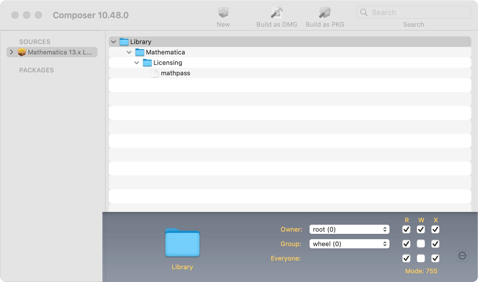

The Mathematica 13.x (network) license can be installed in /Library/Mathematica/Licensing/mathpass
  • Jul 13, 2023 7:18 PM UTC
The license location does solve one problem.  How are you deploying the app?  Even using the DMG like suggested above I get a damaged file warning.  I still have to control click on every install of the .app and click open or I get the corrupt file warning.
Thank you.  This worked for about 1/2 the apps I am having trouble with.  It does not work for all of them unfortunately.
I packaged Mathematica just as usual:
But I always open apps first (to confirm gatekeeper messages) before dragging them to Composer.app.

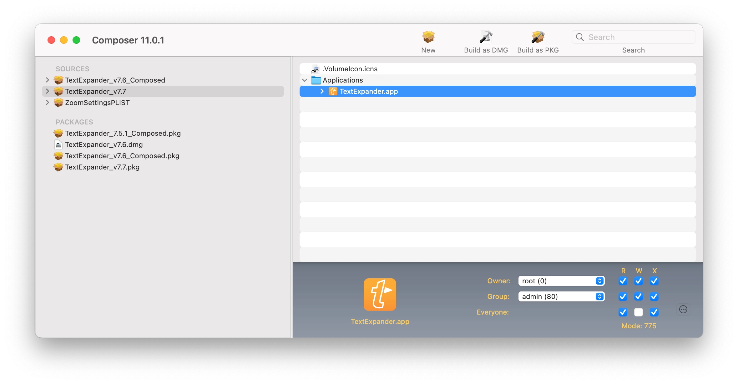

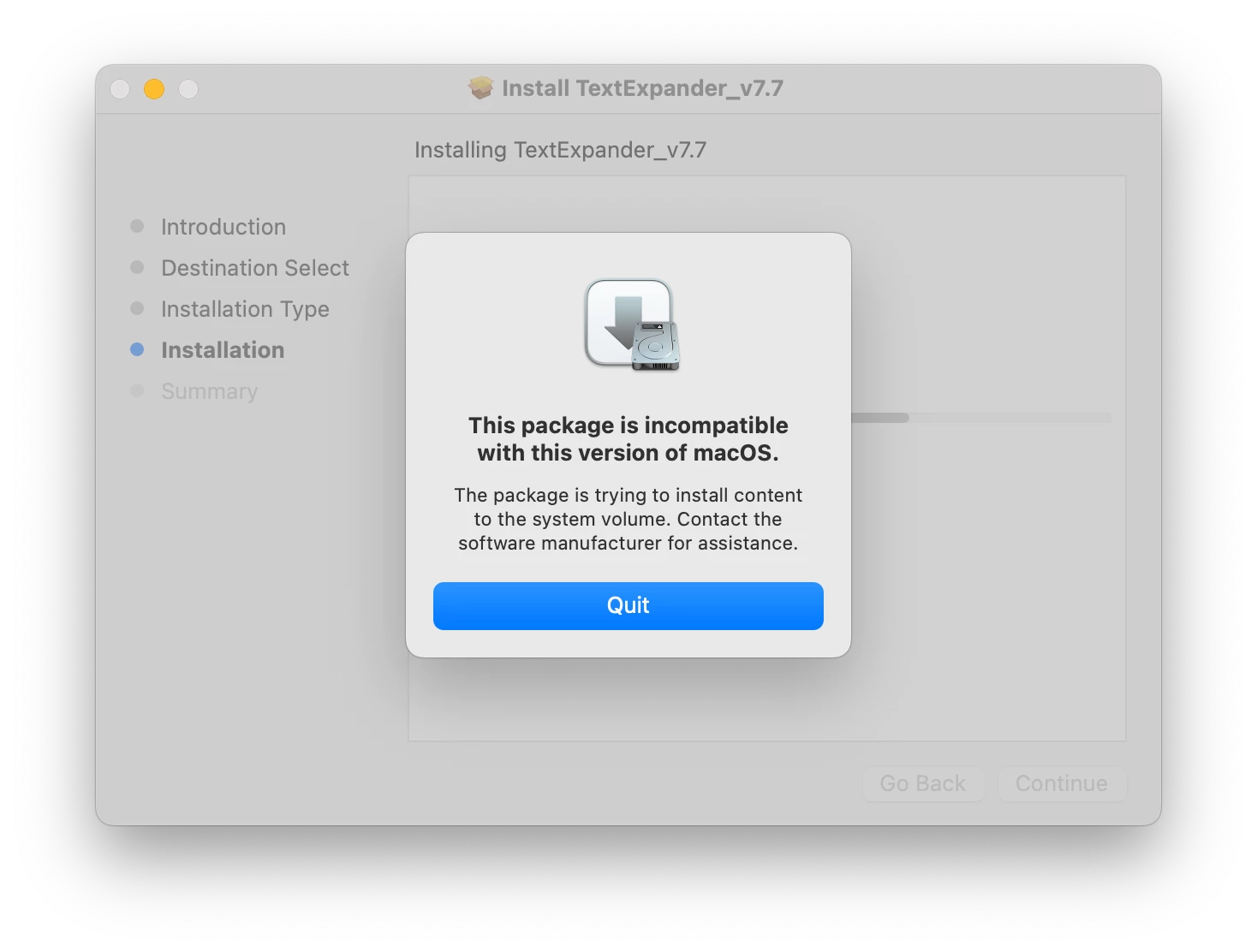

Such a pain. We have a couple of apps that I have used Composer for years on, even at a different employer. Now, does not work. Latest Composer 11.01 and running Ventura 13.6
Get the error when testing the package
chrisB
  • Nov 14, 2023 4:58 PM UTC
Delete the ".VolumeIcon.icns" file from the package.
You may have to navigate to   "/Library/Application Support/JAMF/Composer/Sources/"   to delete the (invisible) file.
Awesome, this method worked for me as well. Thank you for scripting/posting this!
