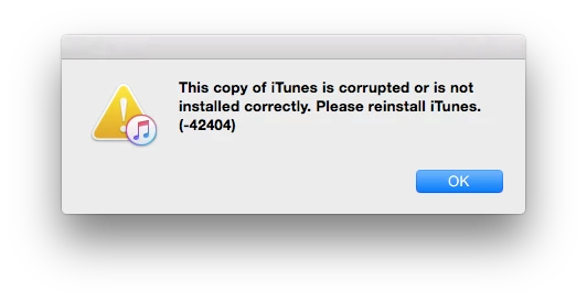

Just trying to package iTunes 12.3.1
On blank 10.11 OS.

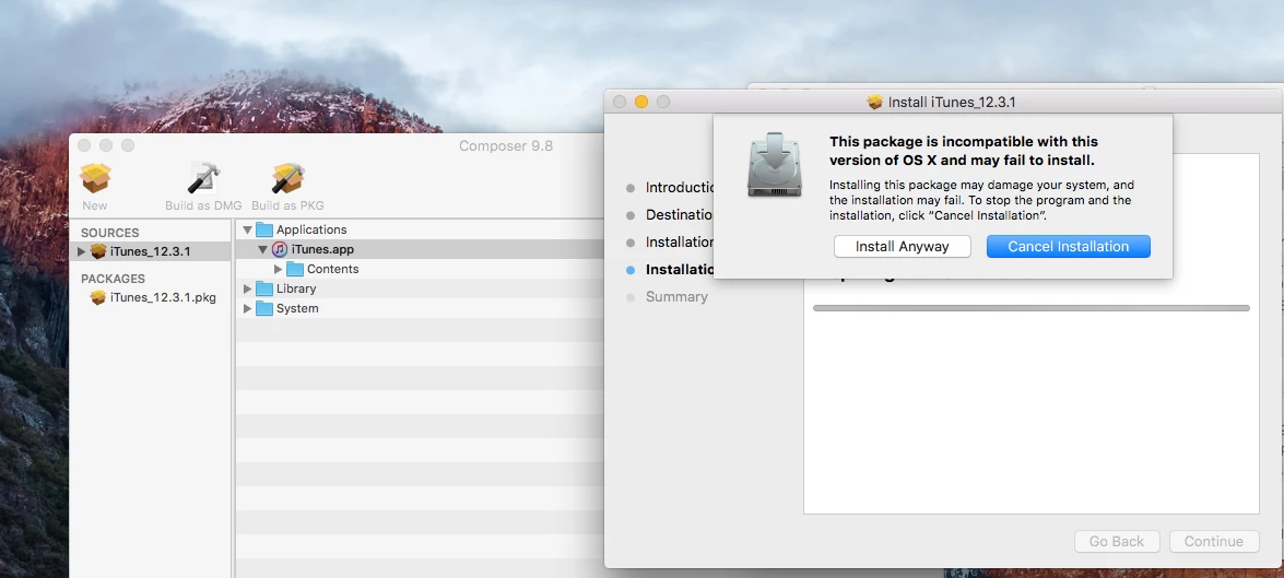

Tried dragging the package from the iTunes12.3.1.dmg into Composer and building a package. The installer worked but then was hit with an error on test machines (screen shot attached). Test machines were both 10.10 and 10.11.
Then under normal snap shot. I captured the installation and my only edit to the files was deleting users. The result was very similar, I'll get a screen shot after I re-image and test.

EDIT - Attached error of normal snapshot.
"This copy of
Best answer by Aziz
@rmhughes
On OS X 10.11 iTunes.app is SIP protected. That means you cannot write to it, only Apple can.
Take the "Install iTunes.pkg" and don't use Composer.
https://support.apple.com/en-us/HT204899
https://derflounder.wordpress.com/2015/10/01/system-integrity-protection-adding-another-layer-to-apples-security-model/

@rmhughes Why are you trying to repackage iTunes? The installer package from the website is a perfectly fine install package. Just drag it into Casper admin and use it.
I know in the CCT classes you may here different opinions on when you should repackage things or not (DMG files with dragging the app into Applications is a perfect example of when you would repackage). But, if the installer works fine on its own, you really shouldn't repackage it as you are gaining nothing.
  • October 26, 2015
iTunes.app has System Integrity Protected (SIP) enabled. It simply won't work without SIP disabled.
Download iTunes from here and deploy the .pkg https://www.apple.com/itunes/download

We generally re-package because we prevent students from having write access from the package contents of an App.
Workflow
Drag install Install iTunes.pkg to Composer
Convert to Source
Create package Run package - Hit with “Installation failed” error
Or are you suggesting, just use the “Install iTunes.pkg” as the file and not use composer at all?

  • October 26, 2015
@rmhughes
  • October 26, 2015
Yes, there is no need to repackage. Use Install iTunes.pkg
What do you mean when you say "prevent students from having write access from the package contents of an App."
In general, try to avoid repackaging at all costs. Use vendor provided packages.

@rmhughes the workflow for iTunes would be to simply drag the Install iTunes.pkg file into the Casper Admin window to upload the package and deploy the package as it is. You should not repackage the iTunes application using Composer. If you have a .pkg file, you're better off trying to use it simply as it is rather than repackage it. Test it and if it doesn't work then maybe you might have to repackage it. Try it with iTunes and see how it works for you.
