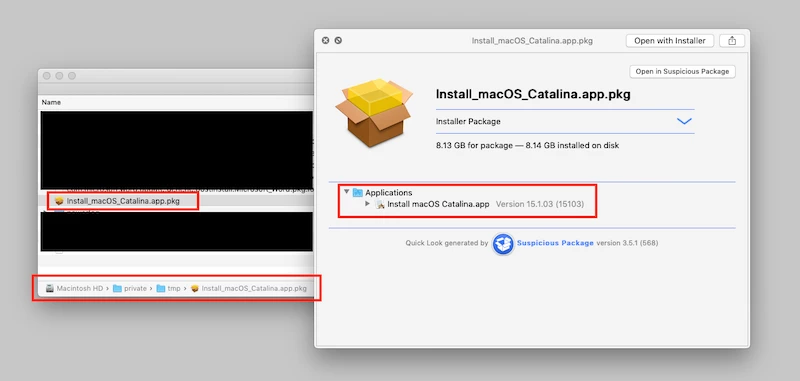

If you have Xcode:
pkgbuild --install-location /Applications --component /Applications/Install macOS Catalina.app /private/tmp/Install_macOS_Catalina.app.pkg
