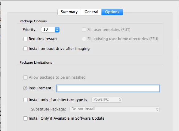

I too use Creative Cloud Packager with success. That being said, I've also used composer quite a bit and thoule is right, you have to be careful of the permissions, etc. How are the plugins managed? Aren't they in a local user folder? If so, Composer should work after the main file has been installed and opened by the user. You might try letting them grab their plugins via self service after opening the new app. I would normally encourage you to make sure that Fill User Templates and Home Directories is checked in Casper Admin,
but that seems to be greyed out since updating to 9.6. But that would make sure the plugins push down to a specific local folder.
