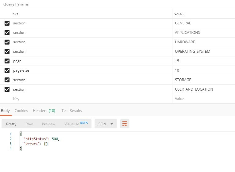

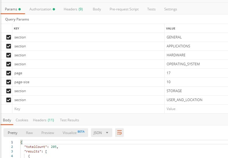

Hello,
For some reason pagination for above call is not working as expected.
Issue: receiving 500 error for random pages.
For example. I have 200 records, then I am doing 10 page size when I am on page 14 no issues, when I am on 15 page receiving 500 error, then I am on 16 page everything working as expected. Can someone help?
