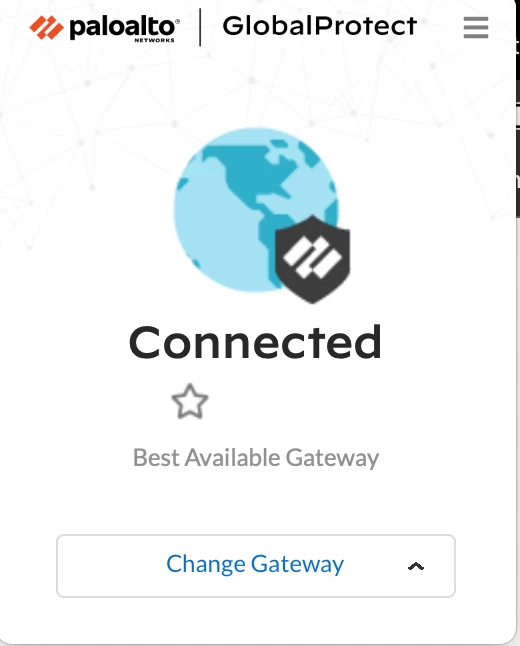

Hi Folks,
I'm putting this here to try to be a little helpful. We just moved from v5 to v6 for GlobalProtect, and basically, the setup that we had that, installed the stock pkg from paloalto and relied on a config profile to set our default portal stopped working. I also couldn't get the app to stop an endless "connecting" loop.
So for anyone who is having the same issue, I hope this is helpful. Long story short, you need to package an XML file that installs the system extension with the app pkg and then run a script to install both.

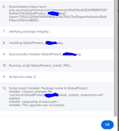

  • Create a script that will install GlobalProtect and the SystemExtension, then deletes the directory that jamf installs from the package that you created. Upload this to jamf pro. #2 in Step 3 of this page has the install command... or I threw it in the script below.
#!/bin/bash #install pkg with system extension sudo installer -pkg /path/to/globalprotectapppkg -applyChoiceChangesXML /path/to/xml/file -target / #Delete directory rm -rf /path/to/directory/that/was/installed exit 0
  • Create a jamf policy and do the following...
    1. Add the package that you compiled in composer and set it to install.
    2. Add the script that sets the portal address to run before the pkg install.
    3. Add the script that does the installation of both the pkg and system extension to run after the pkg install.
This should do the trick! Again hopefully this is helpful! Good Luck!

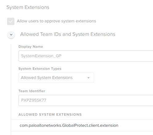

Hey!
I'm following your steps, but global protect still prompt a window with "System Extesion Blocked". Any ideas what could go wrong? I tried everything I found but got stuck on that step...
  • Jan 24, 2023 2:09 PM UTC
@jamf_smap Let's see, I'm trying to think of all the things that could go wrong with a config profile so I spit them all about below.
I would verify that in your config profile in the system extension payload, the teamid is there and correct: PXPZ95SK77 but also that you have
com.paloaltonetworks.GlobalProtect.client.extension
 in the allowed system extensions area under the team ID... after you enter that info you need to click the small save button that is to the right of that area before you click the big save button to save the config profile itself... Also, make sure that the config profile exists on the computer that you're testing this with. if it's still not working post a screenshot and I'll take a look!
  • Jan 24, 2023 2:53 PM UTC
Yes, it is done.
I created xml file with content you used for deployment. I put it in the same directory as GlobalProtect.pkg via Jamf Composer. When I try to run it manually, everything goes fine. Even when I check the policy logs:
It seems like xml file does nothing. I checked ownership and permissions (root:wheel, chmod +x). And still - nothing has changed.
  • Jan 25, 2023 8:23 AM UTC
I FIGURED IT OUT!
Config profile for SystemExtension wasn't set as "Install Automatically" but "Make available in self service", therefore, it didn't work. After change - works like a charm! Thanks for help @sintichn
  • Jan 25, 2023 2:40 PM UTC
Oh my goodness, so happy that you figured it out @jamf_smap. I feel like I always run into weird gremlins that put the kibosh on the end result all the time!
