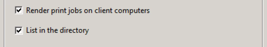

The question that I have regarding the slowdown of your print queues, is when you configured the printers on the Windows Server, are you spooling the job on the server? or are you rendering the print jobs on the client computers before they're sent to the print server?
The first image is on the "Sharing" Tab for the printer in Windows Server, the second image is on the "Advanced" Tab. Try setting your printers up in this manner and see if the print jobs run faster.

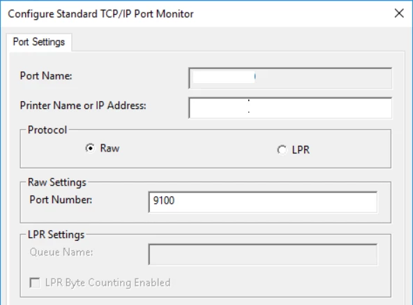

I run our print system which has over 100 MDF's and thousands of users. We had long print delays after a temporary network change in one of our office locations. The cause was due to the print port setting being set to LPR instead of RAW.
With LPR it one job could take multiple minutes to complete a print job, from what I gathered the network changed added some additional latency and I guess it didn't like that. RAW on the other hand was really fast, and it was as simple as changing the setting from LPR to RAW on the printer port in the Windows Printer Server to fix that issue.
Example Times: LPR: 1.35 mins | RAW: 21 seconds
