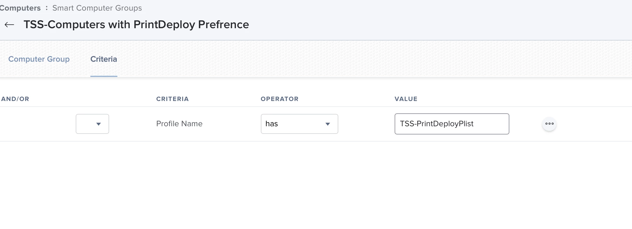

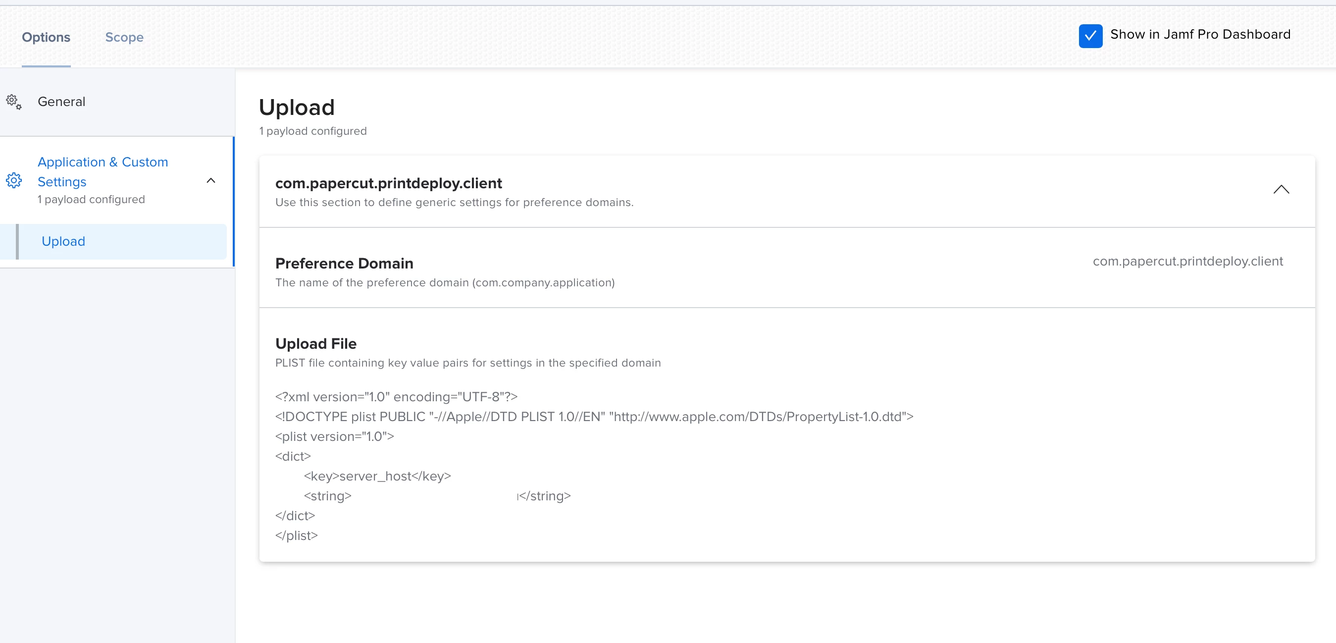

Hello @jzc_SKHIT Here is how we were able to get it working in our environment,  
This is the Configuration Profile we setup to deploy to the machines I just blurred the string where you put your Paper cut server. One thing we did that I would suggest, we only deployed the print deploy packages to the ones that successfully receive the profile, otherwise print deploy acts funny when its installed and the profile comes after. Sometimes a restart would fix it but we decided to make a smart group and auto deploy it to the ones that fall into the smart group:
Hope this helps point to the right direction.

Hi there, sorry for jumping into this so late. I'm currently trying to configure PaperCut with JAMF Pro and am running into issues getting it to work. In the plist, what exactly did you include for the FQDN? for example, we reach our server at http://OurFQDN:9191. In my plist file, I have tried that, as well as just OurFQDN:9191, OurFQDN, http://OurFQDN, etc. No combination seems to work for me. The rest of my plist is exactly the same as shown above.
I'm wondering if my issue lies in the directory aspect. Where is the plist supposed to land when pushed to our Macs via JAMF? When uploading my plist into JAMF as a config profile, after install, I cannot even find the plist on the machine. I've tried manually copying the plist onto the machine, but im unsure of exactly where to place the file. I've tried: Desktop, Documents, Library/Preferences, and /Applications/PaperCut, and all result in the same issue.
No matter what I try, when launching PC Client, I get "The Print Deploy client cannot find it's servers!"
Any advice on how you got your instance working would be appreciated!
Also if there are any logs within PaperCut Client that can point me in the right direction please let me know. Thank you!
  • January 30, 2024
UPDATE: I was too quick to ask for help. I managed to get PaperCut successfully deployed via JAMF. For anyone else struggling with this, the plist config @gabe2385 mentioned above does work flawlessly. My issue was the way i typed in the FQDN. It should NOT contain https://, and also not the port in brackets. My issue specifically, was I had a "/" at the end of the FQDN in my plist (<string>OurFQDN/</string>) This was causing the PaperCut Client to direct to the server "https://OurFQDN/:9191" rather than "https://OurFQDN:9191".
How I discovered the problem: I installed PCClient via our organizations direct URL download on a fresh device without PCClient, went to /Applications/PaperCut/data/config/ then read the file client.config.toml . Find the line "ServerBaseURL = "https://OurFQDN:9191" This is an example of a working config. Go back to the device that's failing to reach the server (when trying to deploy via JAMF) and navigate to the same file. Compare the ServerBaseURL line with the one from the working device. If there are any discrepancies, you will know what to alter in the plist. For me, the config was reading "https://OurFQDN/:9191", which led me back to my plist, where I had written "<string>OurFQDN/</string>" I removed the Config Profile from the machine, edited the plist, reinstalled the Config Profile, reinstalled PCClient from Self Service .pkg, and it points to the correct server! Thanks to @gabe2385 for sharing the plist information!
