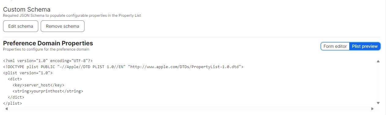

For my company, I wrote a custom JSON file instead of a plist with all the accepted values instead of a plist. Main reason I did that is I hate generating a new plist file if something changes also if you need to add extra value you do it easily in browser. If you want a copy, it's here
Using the custom JSON file instead means the steps a little different. A few more steps but for settings that may change I'd say it's worth it.
  1. Log in to your Jamf Pro instance, for example, https://your-company.jamfcloud.com
  2. Click Computers > Configuration Profiles; then click + New.
  3. Type the display name and description.
  4. On the left, scroll down to Application and Custom Settings; then click Add.
  5. Click External Applications
  6. Change Source to Custom Schema
  7. For the Preference Domain enter com.papercut.printdeploy.client.
  8. Click Add Schema
  9. Copy and paste the code from my Git hub link above
  10. Click Save

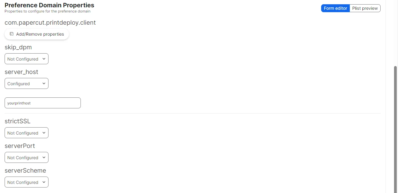

  11. Click drop down under server_host and change to configured
  12. In the text box enter your papercut server information
  13. Click the Scope tab and deploy the file to the appropriate computers.
  14. Click Save.
JAMF will do the plist work for you and push it out to the machines you scope it to.
