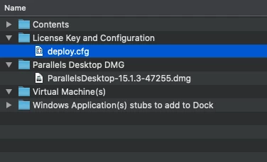

I downloaded all packages again from their website.
Autodeploy package seems to be version 15.0.0 from the logs
Then the only thing I did was dragging the Parallels Desktop 15.1.2 DMG to the Parallels desktop folder and editing the config file to add our license key.
That Autodeploy.pkg was uploaded to Jamf and deployed using the Jamf Self Service app

I downloaded the autodeploy, opened the package contents and dragged the Parallels DMG into that.

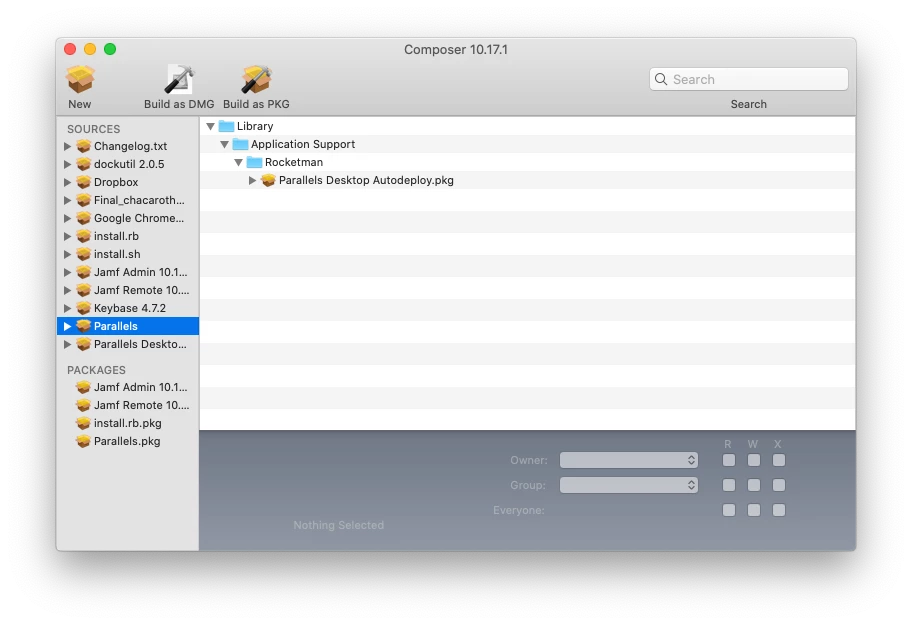

I'm having the same issue. If I install it manually through the GUI it works fine. When I deploy it through Jamf, I get the same error you had.
  • Dec 30, 2019 11:39 PM UTC
I was able to deploy it by wrapping the PKG into a PKG and running:
installer -pkg "/Library/Application Support/Rocketman/Parallels Desktop Autodeploy.pkg" -target /
I think, maybe, when editing the contents of a PKG it becomes "unsigned" making Jamf not trust it? I'm not sure, but running the PKG through a script seems to work for me. Let me know if you get that to work @DennisMX

I am deploying Parallels Desktop Business Edition v15 to all Macs. I dropped the pkg payload and the license key into their deployment kit and it is working for me. The logs you posted seem to bark about a postflight script in the PKG. how exactly are you deploying it? Also, I think this also happens if you are using their licensing and out of licenses FYI
Forum|alt.badge.img+31
  • Jan 4, 2020 4:14 AM UTC
Also, the deployment kit is a non flat package, non deep signed package, and not notarized meaning if you download it from the internet, with a browser it will have quarantine tags on it for Gatekeeper. To get around this, you can run xattr -c /path/to/package.pkg to strip out the flags and it should run if that is in fact your issue

I got this fixed while working with support.
When packages are uploaded to jamf they are zipped.
When using Chrome the zipping process will break the application when deployed using jamf.

@JarvisUno All I did was put in my license key in their script and drop the parallels DMG into the package and then tossed it into jamf

@Ken.Weinstein I just followed the Parallel's docs on this. They have a tool you can use to do this and that is what I followed. I didn't do anything custom outside their docs really.
