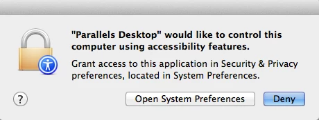

On a side note, anyone know how to kill this prompt?
Parallels' dev team appear to have never come up with a solution.

karthikeyan_mac
Forum|alt.badge.img+20
  • October 29, 2015
Hi @donmontalvo ,
Try the below to suppress. (Not Tested since we use VMware)
sudo sqlite3 /Library/Application Support/com.apple.TCC/TCC.db “INSERT or REPLACE INTO access values (‘kTCCServiceAccessibility’, ‘com.parallels.desktop.console’, 1,0,1,NULL,NULL);

Hi @karthikeyan.mac and @Abdiaziz, we followed up with Parallels on how to get their product from not automatically adding itself to System Preferences > Security & Privacy > Privacy > Accessibility. We don't want to tweak OS X behavior, just want them to stop putting it there unless we want it to go there.
  • December 31, 2015
You can remove it from the accessibility list after installation like this using tccutil.py:
brew install tccutil
sudo tccutil --remove com.parallels.desktop.console
I realize this post is a bit old, but I ran into it recently when I was tasked with deploying Parallels.
Thanks.
donmontalvo
Forum|alt.badge.img+36
  • December 31, 2015
@jacob_salmela awesome, I'll pass that info along to the Parallels engineers. :)
Hoping Parallels can offer a prompt, to let user/s decide whether to add it or not.
