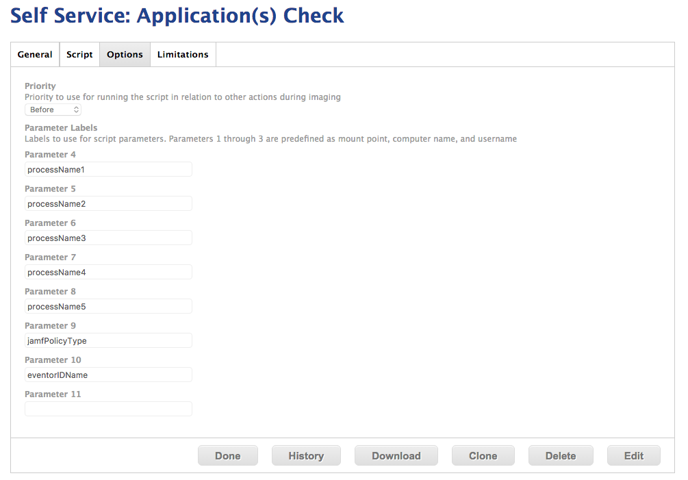

Greetings, all! I have a pretty (what I believe to be) nifty script which checks to see if specified processes or applications are running before executing a policy.
My first really application for this is to be used for Office 2016 updates. I would pass the five Office applications (Excel, OneNote, Outlook, PowerPoint and Word) as the processNameX variables where X is an incremental integer beginning at 1. I also pass the jamfPolicyType and eventorIDName variables in the policy itself with "-id" and "841" respectively. The 841 integer represents the policy that I have created which simply installs the package when it is called on. I have a similar script but it only has 1 processName variable/parameter and it works flawlessly both locally and when used in the JSS. I made a few modifications, all of which were pretty simple, to accommodate for the added parameters being passed. This script runs beautifully when I run it locally and in the JSS when I pass the variables in the script itself but throws an error when I use the parameters at the policy level. Specifically there is an error with the eventorIDName parameter. The following error is received:
No policies were found for the "/0" trigger.
To correct this, I have to pass the -id associated with the policy I would like to run in the script. When I do this, it works with no errors whatsoever. I have also tried running other policy -id as well (like 1 for the update inventory default) all of which yield the same above error. For reference, please find my screen capture of the script details below.
Any thoughts? What am I doing wrong here?

Best answer by chriscollins
@sepiemoini any positional parameters higher than 9 in bash need to use a more strict variable expansion. For parameters 10 and 11, where you are using "$10", "$11", change then to "${10}" and "${11}"
  • Nov 19, 2016 5:47 PM UTC
sepiemoini
Forum|alt.badge.img+21
  • Employee
  • Nov 20, 2016 2:27 AM UTC
Excellent, thanks @chriscollins--that did the trick!
