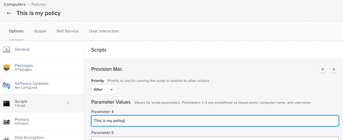

@aparten, have you considered a script and a script parameter in a policy?
If your script includes something like this:
policyName="$4"
echo "$policyName"
and then in your policy put its name in the Parameter 4 field, it should echo whatever you put there. Anything echoed in a script run via policy is included in the policy's log.

@talkingmoose - I did try that, but the info I need is from the first policy and the actual script is ran separately in the last policy being triggered.
