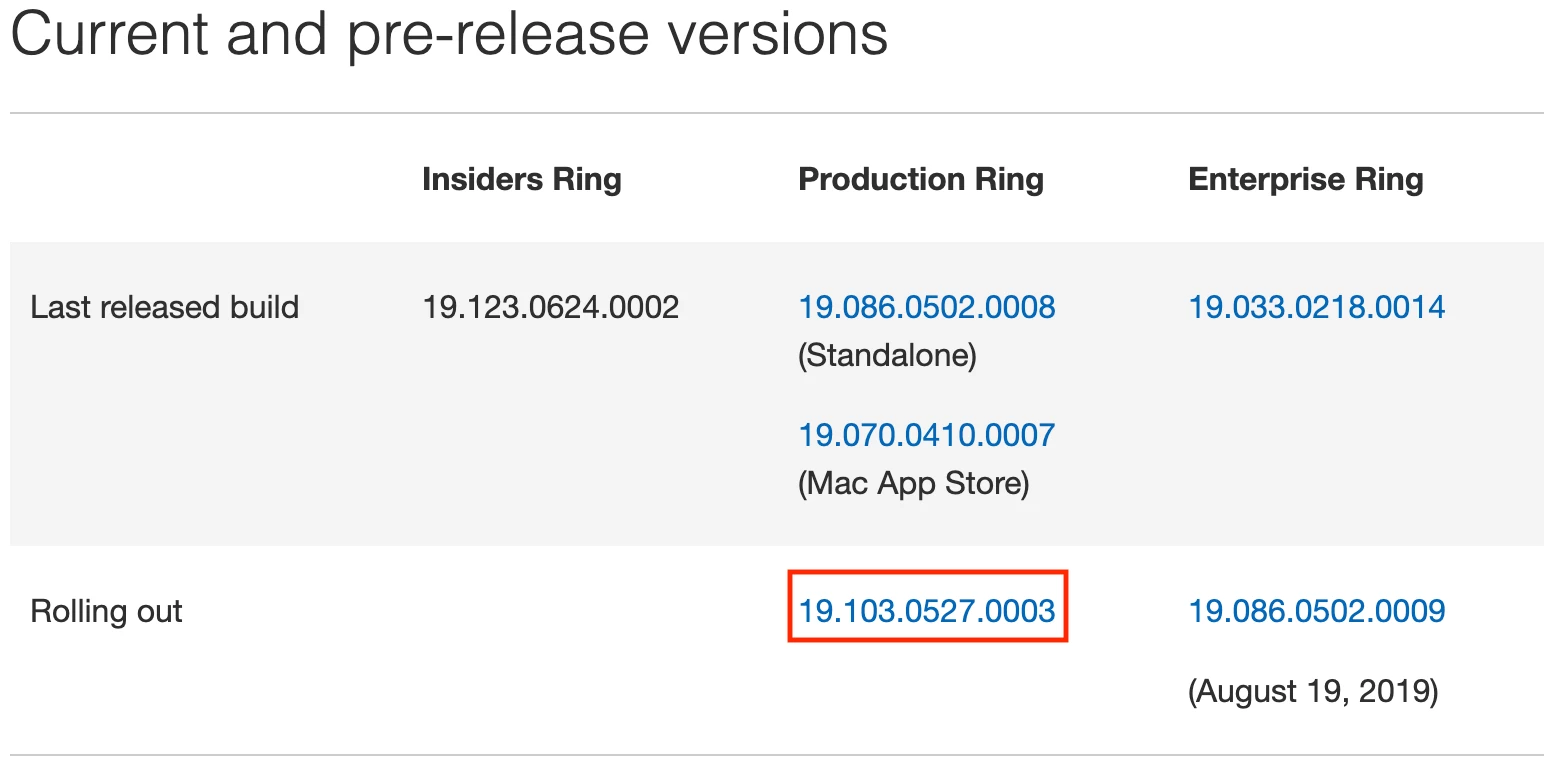

Patch management is currently reporting 19.086.0502 as the current version however 19.103.0527 is currently deploying to the Production ring and virtually all my fleet is now reporting an unknown version in Patch Management.

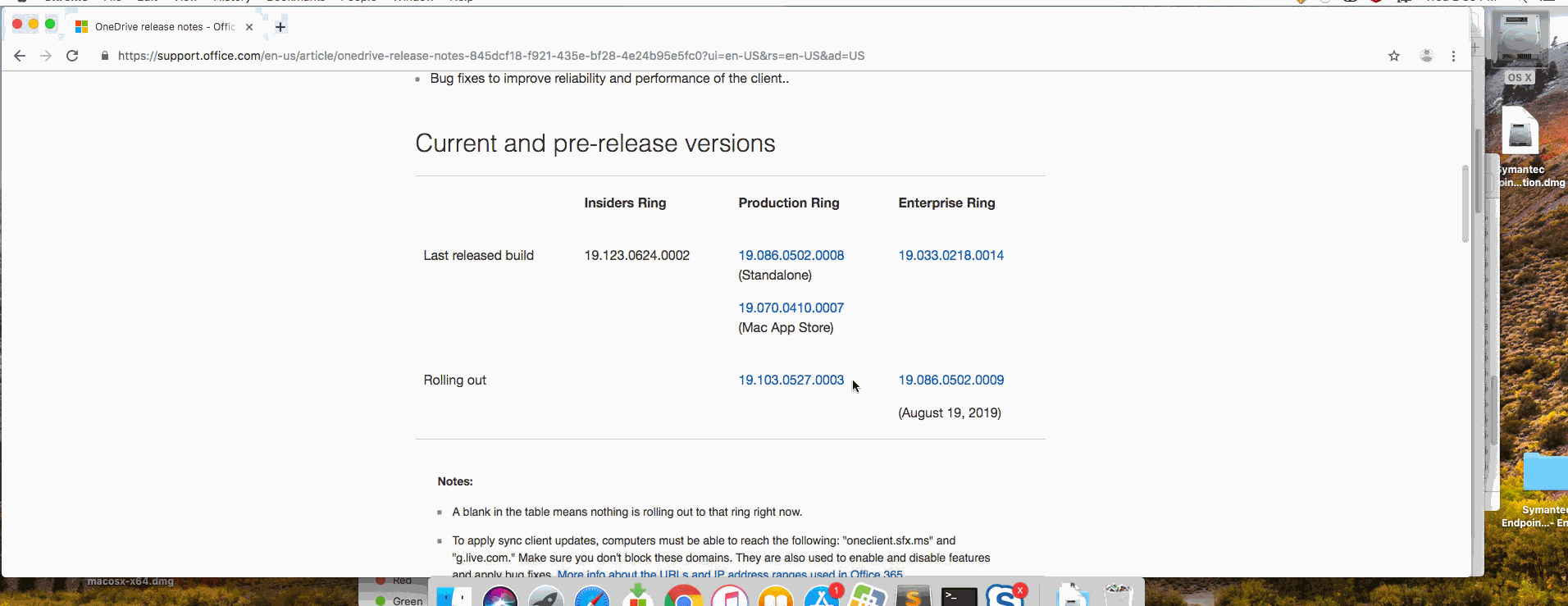

We get our information for OneDrive at this location: https://support.office.com/en-us/article/onedrive-release-notes-845dcf18-f921-435e-bf28-4e24b95e5fc0?ui=en-US&rs=en-US&ad=US
We use the Production Ring, Rolling out, version for the definition. It's been this way since the definitions inception. Here's the problem we're seeing here at the moment, 19.103.0527.0003 is the version that's currently being shown. However when trying to download that link it still gives us 19.086.0502.0008 - the previous latest version. We've been watching this for about a week straight waiting for the link to be corrected or for https://macadmins.software to show version 19.103.0527.0003, which it hasn't yet.
Our stance is that we typically will not release an update for a Software Title unless we are able to download and test it via the Quality Assurance department prior to the release. So at the moment we're being held up because we cannot get a hold of 19.103.0527.0003.

The download link for 10.103.0527.003 is here - I obtained it from the page you referenced (it's hyperlinked from the version number):

If only it were that simple right? Every time myself and a coworker download and install from that link we are still getting 19.085.0502. Clearing cache or using incognito doesn't make a difference. I've enclosed a gif. If this is where you obtained version 19.103 I'm curious if they pulled it and then will release it at a later date. If you have another public facing link I would appreciate you sharing.
