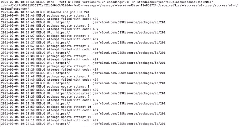

To follow up on this for anyone reading: I've updated the JPCImporter post-processor to @honestpuck's JPCImporter v3 which leverages the cookie-based approach, and am still receiving the HTTP 409 conflict.
Potential solutions I've tried:
  1. Set the delay between initial package upload and updating the package to 10 minutes via sleep(600), no luck.
  2. Set the delay between package update attempts to 2 minutes via sleep(120), no luck.
JPCImporter logs:
This is driving me crazy, but I haven't lost hope yet.

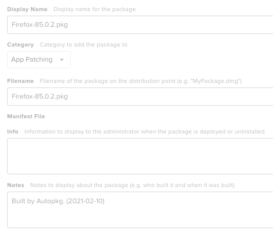

I finally figured it out. Whew!
The answer was much simpler than I had imaged. So, when I was getting to the package update part of the JPCImporter post processor script, it kept failing with the 409. Upon investigating the script, I realized that I didn't have an Applications category on my Jamf Pro instance, hence why the package couldn't be updated. I suppose Jamf was interpreting this mistake as the package is "older" than the one we just uploaded, thus throwing the 409 HTTP conflict error.
The Resolution
All I had to do was create the Applications category on the Jamf Pro instance, then run the script again. Issue resolved.
