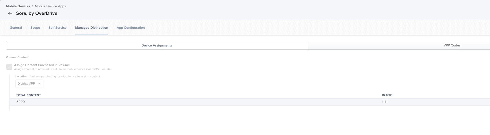

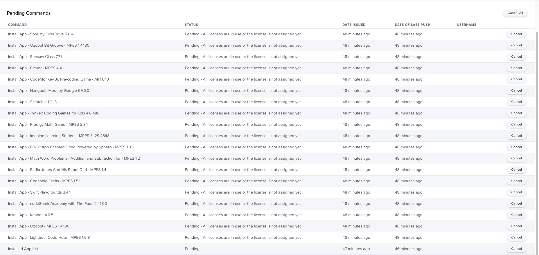

Hayden_Webb
Has anyone else run into this issue? It seems to be happening more and more to the point where most apps aren't installing. The weird thing is, this doesn't happen on all iPads, they will be the same type and the same iOS. Also, it's not the same apps that have the issue. I tried wiping them, connecting to a different network, renewing the VPP token (it was almost expired), updating the iOS, and creating a new policy. There are plenty of licenses available. I'm fairly new to JAMF with only the 200 experience so I'm sure it's something dumb that's causing it, I just can't figure it out.
Any help would be greatly appreciated!

So, I created a test VPP server, got a few licenses for some of the apps that wouldn't install, then scoped them just to Self Service of the iPads with this issue, and the apps started installing.  It seems to be just an issue with our main VPP server. Still not sure what would cause this issue though.

We are having the same problem. Our Jamf Pro Server is on Prem and we upgraded to 10.30.1 on 8/10/21 and that is when I started noticing this problem. Our main Location under settings-Volume Purchasing showed zero for all our apps. I created a new location and assigned a couple apps and those seemed to work.
We then contacted Apple and they claimed everything was good in our ABM account, it must be a Jamf problem. I opened a ticket with Jamf and they said everything seems to check out, it's a token problem in ABM. Back to Apple and no it is a Jamf problem. By this time a week and half had went by so our solution was to move all our apps to the new location. I really think it is a Apple/ABM problem but I can't definitively prove that.
We ended up having to remove Self Service and re-add it, on a new device Self Service was requesting to be purchased.   We also upgraded to 10.31.1 and so far all apps are working as expecting.

We had solved our Problem  ONE APP has made the problems.
We disabled and deleted this app!  Wonder,version=1147,
2021-11-17 13:54:49,759 [ERROR] [hread-31691] [dmControllerProcessorImpl] - Exception processing MDM request
