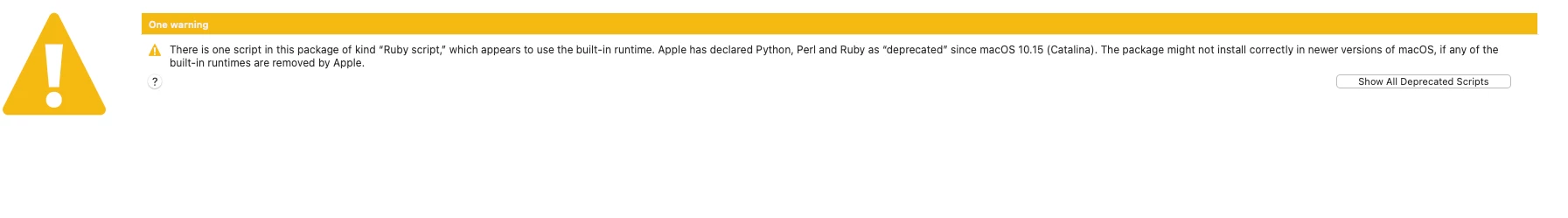

Nothing jumping out @RaGL  not sure if this is related
Seems to be talking about the preinstall script which use
usr/bin/env ruby.
I have ruby under usr/bin/ but not env ruby I assume there is a difference.
