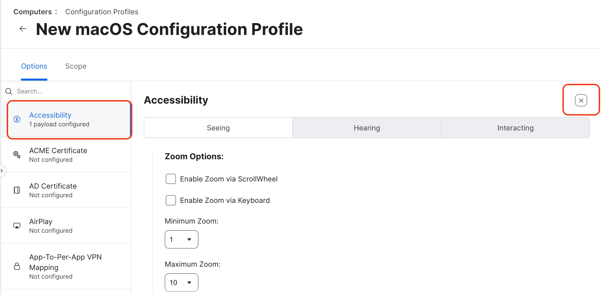

Hi @skhan619 ,
First, the Pointer Size setting is grayed out and cannot be edited because the Configuration Profile > Accessibility setting is enabled. Even if no specific options are selected, the Pointer Size remains grayed out.
To resolve this, remove the Accessibility setting from your configuration profile.
If you need to add a custom accessibility setting, use the iMazing Profile Editor app. Create a new profile without enabling or selecting the Cursor Size option. Once you have created and uploaded the profile to Jamf Pro, the Pointer Size setting will no longer be grayed out.
Note: Customize the profile according to your organization's needs, ensuring it aligns with the department or scope you want to configure.

Appears a Jamf Pro administrator may have deployed a computer configuration profile that includes the Accessibility payload. Under the Seeing tab you'll find a setting for Cursor Size.
The only way to allow your developers to adjust this is to exclude their computers from this configuration profile.

agungsujiwo
  • Mar 18, 2025 1:34 AM UTC
Hi @agungsujiwo I explored this previously and could not find the payload to edit?  I checked under 'restrictions' but nothing. Any idea where thanks?
Hi @skhan619 ,

  • Mar 24, 2025 12:39 PM UTC
Hi @skhan619 ,
This is very strange.
I tested it on a Mac, and the Pointer Size setting is grayed out when the Configuration Profile > Accessibility is applied. However, it becomes editable again once the Accessibility configuration profile is removed.
It seems like you may need assistance from Jamf Support. I suggest creating a support ticket for further investigation.
I went thorough all the profiles and eventually came across one which was a blank payload for accessibility - removing it and voila issue fixed.  Many thanks!
