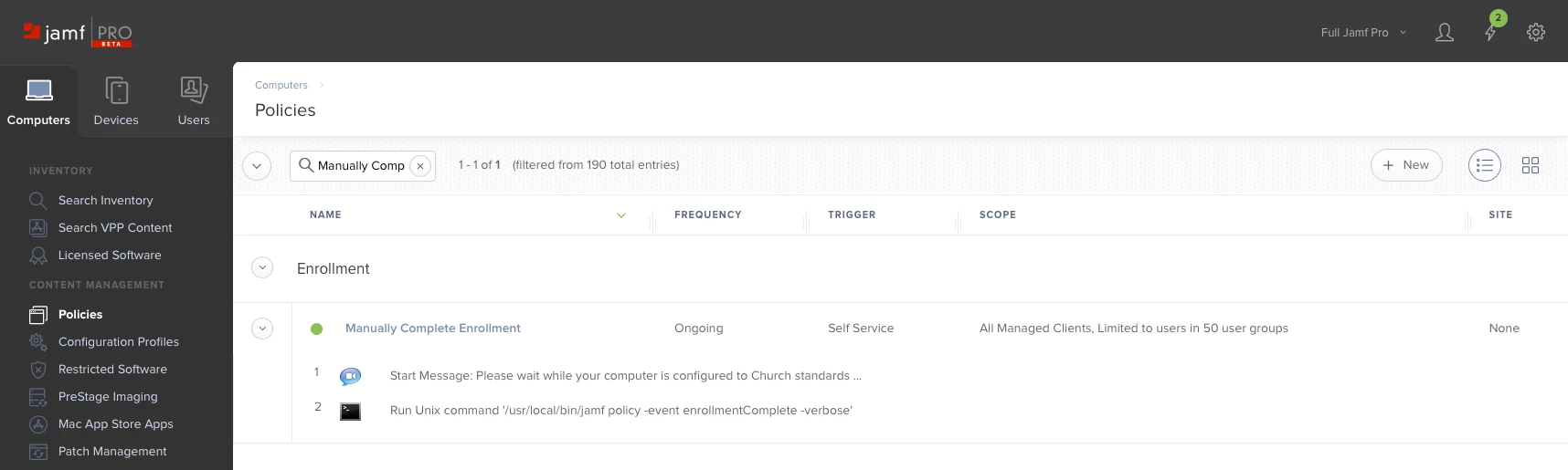

We have a Self Service policy scoped to TSRs which executes the following command:
/usr/local/bin/jamf policy -event enrollmentComplete -verbose
What does it do exactly? I guess it calls the policy @enrollmentComplete to start..but I may be wrong
And..does it start the @enrollmentComplete flow only if it was not flown, or also if the policy @enrollmentComplete were already deployed..?
Till now, thank you for your support in any case..!
Really appreciated
  • May 23, 2019
@dan-snelson That Self Service policy is a good idea. I'm gonna steal it ;)
@corpffhelpdesk2l The network state change trigger doesn't work reliably to begin with, and it has been known to cause problems with the Enrollment Complete trigger. Disabling it increased the success rate of my Enrollment Complete policies, but didn't completely resolve the issue.
The /usr/local/bin/jamf policy -event enrollmentComplete -verbose command will trigger the Enrollment Complete policies as if the enrollment did just complete, regardless of whether or not it has already flown. Of course, execution frequency still applies, so if you have an Enrollment Complete policy set to execute once per computer or anything other than ongoing, that policy will not run again if it has already run on that computer.
