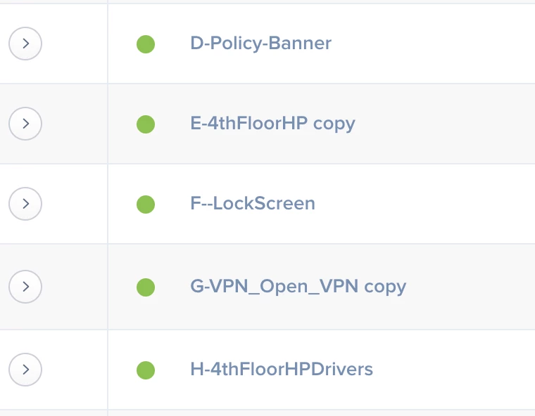

  • September 18, 2018
@el2493 Here are my policies after putting alphabets next to them. I originally had them with numbers 1 and so on before them.
@mm2270 has helped me out a lot in the past (both answering my personal questions and also just seeing his answers to other questions all over this website), so I would usually go with what he recommends. Alphabetical works consistently for me, but scripting is definitely foolproof when it comes to running things in a specific order. It could be something as simple as using a script like this in a Policy and having this be the only Policy that runs on enrollment:

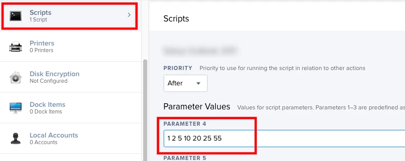

@mm2270 So I have the 16 policies without any execution triggers now. How would I setup the string in parameter 4 for them to execute in order. I also dont have any custom triggers set to them either. I want the policy that has the script to run first during enrollment. Afterward it should call all of the other policies in order by policy ID. Some of this might sound like i'm asking the same question. Not sure how I should be asking this. I removed the execution triggers from all 16 policies. The example you gave shows custom trigger names in the parameter 4 section. I dont have any custom trigger or execution triggers. How would i now write the string in parameter 4?
mm2270
  • September 19, 2018
@kadams Yes, you just put all the IDs in the order you want them to run, left to right in the param 4 field, like
1 2 5 10 20 25 55
