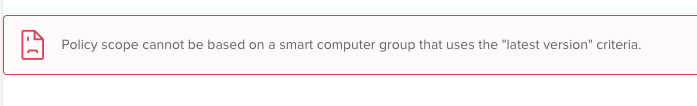

Policy scope cannot be based on a smart computer group that uses the "latest version" criteria.
  • Sep 16, 2016 12:22 AM UTC
  • 12 replies
  • 217 views
Found this nice little limitation a little while ago. So basically, "patch reporting" can't be used to do anything actionable, like, say, patch something.
The use case was checking for machines not on the latest version of Chrome, and if found, running a script like this:
#Command will trigger Google's native updater process in the background
cd /Library/Google/GoogleSoftwareUpdate/GoogleSoftwareUpdate.bundle/Contents/Resources/
./CheckForUpdatesNow.command
And then update inventory to have it drop out of the computer group.

I noticed the same thing. It seems odd that you can't scope based on latest criteria. Maybe someone from JAMF will comment on why this is.
  • Employee
  • Sep 16, 2016 4:47 PM UTC
@pmcgurn (and @mpermann), check out my response to the same question on this KB: https://jamfnation.jamfsoftware.com/article.html?id=443
I think your use case (and @chad.jannusch's) is a little less dangerous than the one we were originally worried about, but you could still end up in a sticky situation if you used a smart group for "is not latest version". For example, if a new version of Chrome is released and one of your end users happens to install the new version on their own before JAMF has updated our definition of "latest version", the JSS will consider them to be on an "unknown" version. "is not latest version" will pull in computers with unknown versions, and your script will try to run on that computer that's already up-to-date but reporting as unknown. If your policy is set to ongoing, the script could run repeatedly until JAMF updates our definition of "latest version".
"less than latest version" would probably be OK...
We'll think about potentially removing this block and providing more of a disclaimer instead, but ultimately our focus is on building a more purpose-built solution so that you don't have to use complicated smart groups and policies to patch your machines. (We are also working on minimizing the amount of time it takes us to update our definition after a vendor releases an update.)
