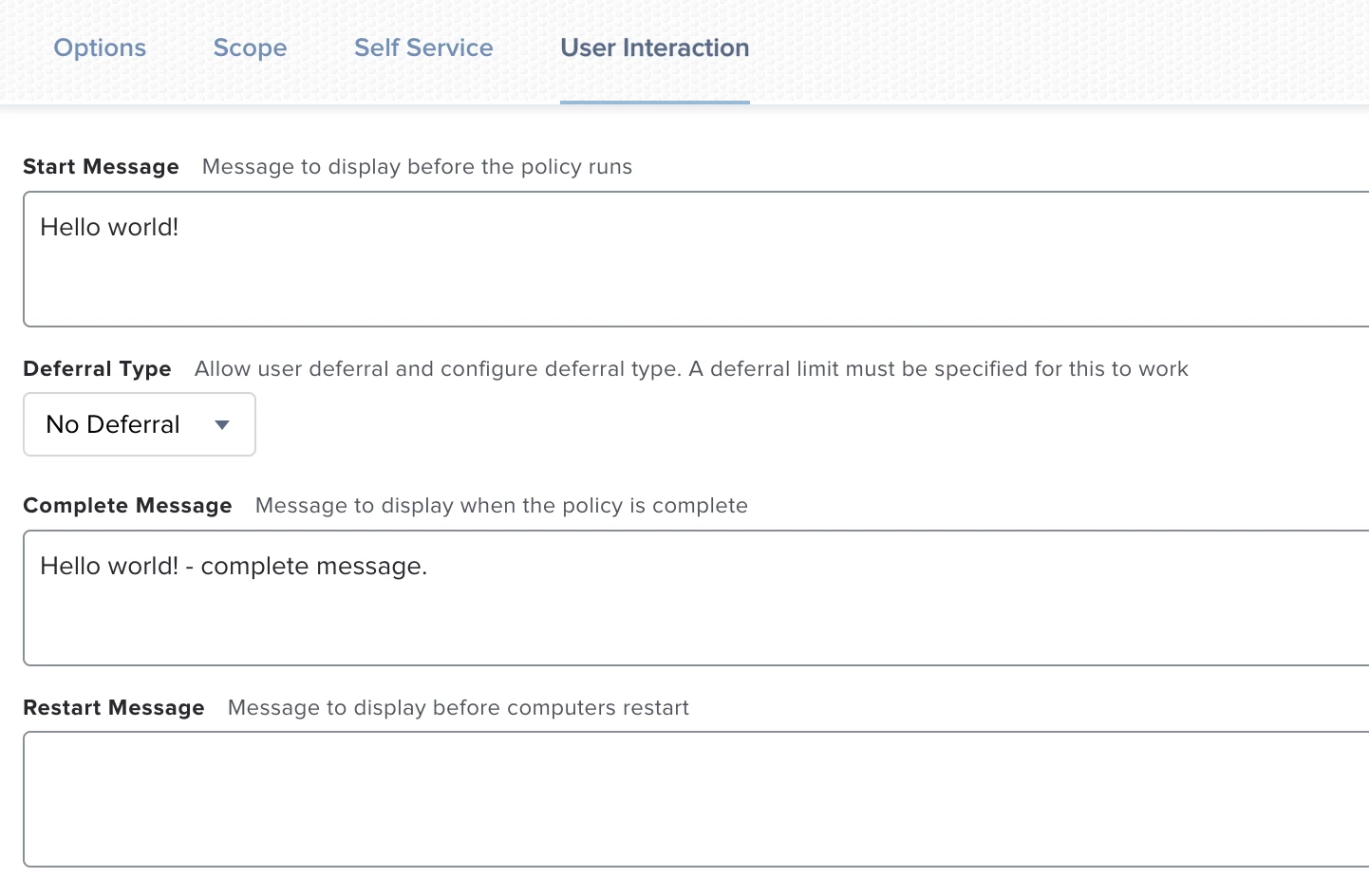

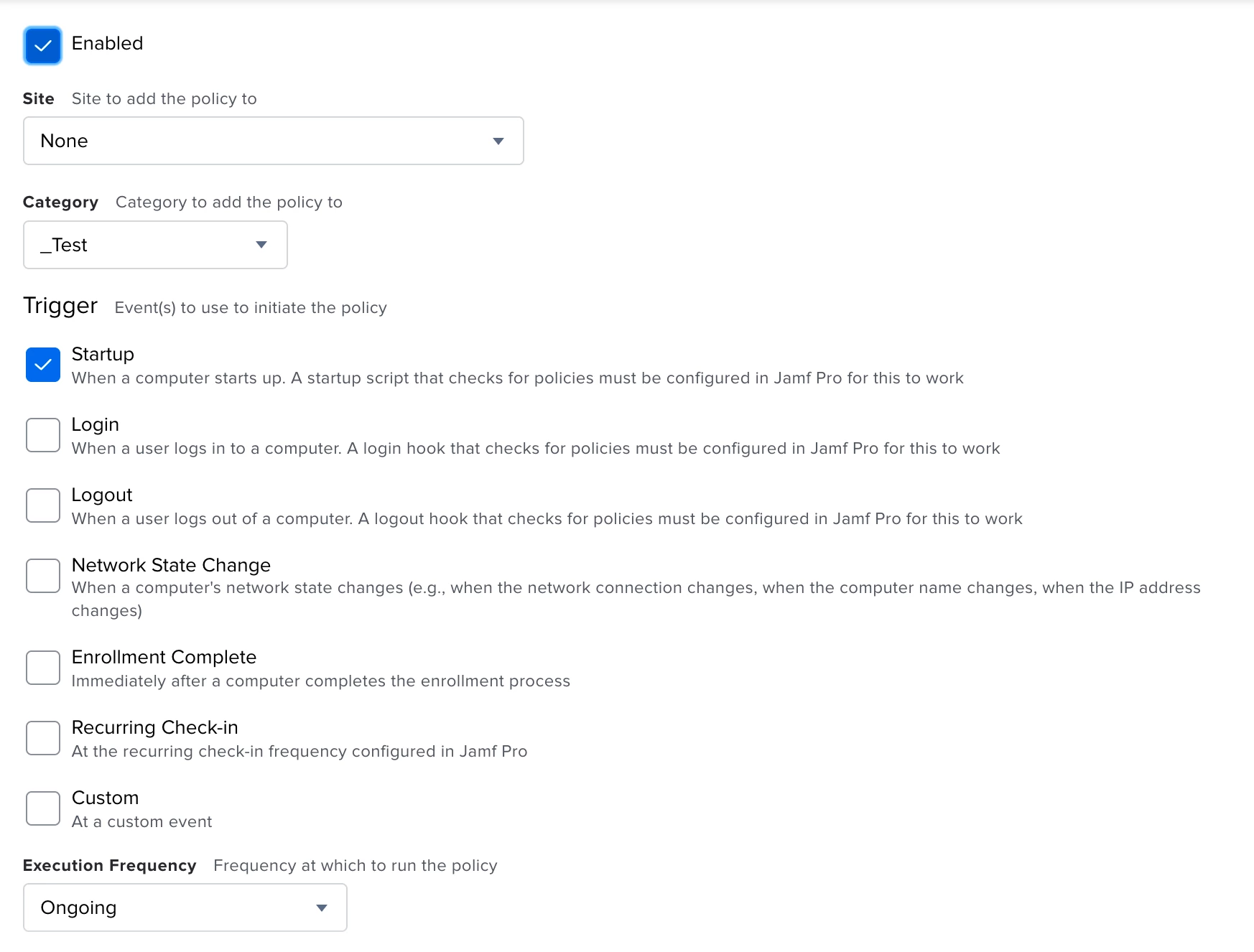

I would like to send a message to certain users via popup message. Unfortunately, all the methods I have found here do not work.
I have already made the following settings:
In addition, I choose my user in the scope. Unfortunately, I do not receive any notification. What is the reason for this?

@mickl089 Do you also have a Startup Script configured? Do other policies with a Startup Trigger work as expected?

@mickl089 I don't think you should be using the Startup trigger for a policy that would display a message to the user. Startup literally means when the Mac starts up, which is not the same thing as login.
If you explain what the end goal and purpose is for a message to display this early on at each boot (you have your policy set to Ongoing), then maybe there's a better way to do this, such as a Policy Banner?

@mm2270 I want to set that a user gets a window or a message after login that he should update to macOS Big Sur. Just a little hint that you can also end with "OK" :-)

Ok, so in that case, you could try enabling Login / Login hooks in Jamf and set the policy to Login instead of Startup. As I mentioned, typically Startup isn't a good trigger to use for a user type message because it's likely the policy is firing off before an actual login to the desktop has happened. Be aware though that a lot of folks have problems with login policies these days, in that they often don't work properly, so YMMV on using that trigger.
If you find it's also not working for you, you could consider using a LaunchAgent and script deployed to the Macs that you want to target for this. You'd have to manage this in a way that after they upgrade to macOS Big Sur that the LaunchAgent and/or script gets removed or else they'll get the message coming up again. LaunchAgents run as the logged in user, meaning they don't actually activate until a login happens.
You can call up messages using things like Applescript (osascript in a shell script) or jamfHelper (/Library/Application Support/JAMF/bin/jamfHelper.app) or even just using the jamf binary's displayMessage verb, just to name some examples.
If you need help crafting some of the above, post back and I'm sure one of us can put something here to get you started.
