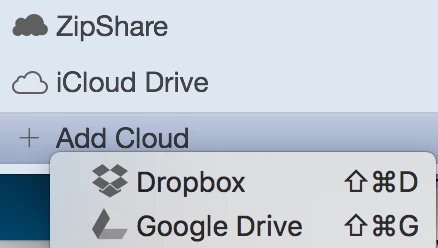

Hey All,
How to remove or hide ZipShare & iCloud options on WinZip for Mac
