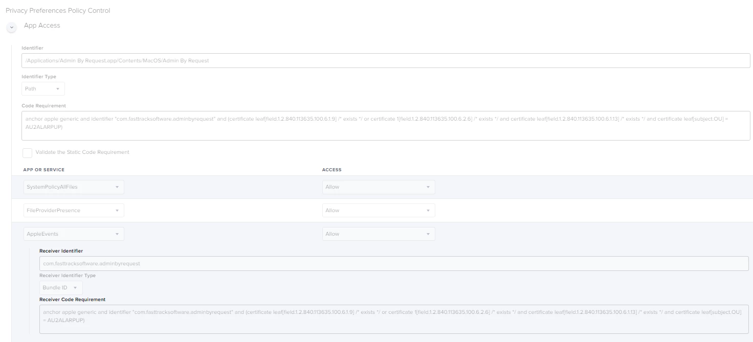

Hey all. I'm still fairly new to all this. I've been trying this for a couple of days now, and I cannot seem to get the proper permissions for AdminByRequest to work. Per this article, I need to allow SystemFilesAllAccess for ABR. I've been using PPPC Utility to created the profile, and I have tried a few different combinations of settings, but none of them have worked. I know it will not show in the Security settings on the Mac, but in profiles, my PPPC is there, and it still not working. I've uninstalled and reinstalled the app with the profile applied, still nothing.
Has anyone had any experience like this, whether with ABR specifically, or another app, that could give me some pointers?
This has all been on a singular test computer on Monterey, and I need to try to deploy this PPPC to about 80 or so machines, so the manual route is not really an option.
Thanks,
C

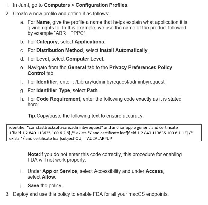

Best answer by cako1955
So I also had a support ticket in with AdminByRequest. They provided me with the following, which wound up working. I hope this can help someone in the future.

  • Feb 21, 2023 9:43 PM UTC
Here is my most recent attempt. They started out as basic as just the identifier, the code req, and allowing full disk access, and gradually grew to this. I've been doing a ton of googling, and trying anything I have seen.

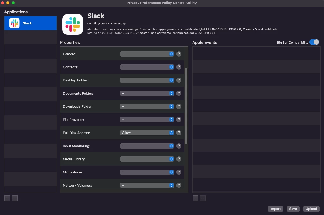

  • Feb 22, 2023 3:18 PM UTC
Please try the following:
  1. Go to PPPC Utility
  2. Add the adminbyrequest app
  3. Click Full Disk Access to "Allow"
  4. Press Save and fill in the information needed
  5. Upload the mobileconfig file to Configuration Profile in Jamf Pro
  6. Make sure to scope to your test computer
  7. Restart your test computer
  8. Check the Profile in the test machine to make sure the Configuration Profile has been installed.
  9. Go to Security & Privacy and you should be able to enable it.

Note: Below is an example as I don't use adminbyrequest.
Yup, just did all of this step by step. Upon rebooting, confirmed that the profile was there. I then tried to run an installer by dragging it onto adminbyrequest, and I still received a pop-up saying that it does not have full disk access.
  • Feb 24, 2023 1:14 PM UTC
