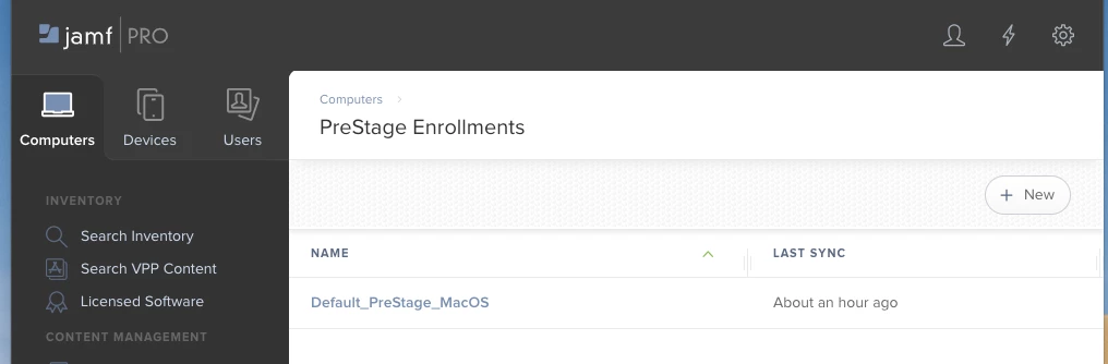

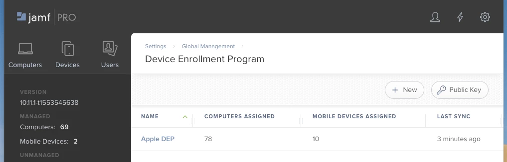

We have a similar issue. I noticed that our DEP was showing an error connecting to the server. Although the Token was not expired, I went ahead and uploaded the latest public key to the apple business portal and downloaded and installed a new Token.
Under 'All settings> DEP' I see that we are syncing with Apple every 5 minutes as expected.
However, our pre-stage has not synced in over an hour.

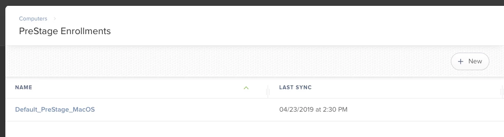

  • Apr 25, 2019 4:13 PM UTC
Hi @arivera ,
I also went through this process as you can see from my original post, however, even though everyting is functioning as expected, the "last sync" field has not updated since the Token was updated. Are you seeing the same?

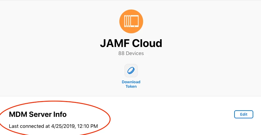

@simon.brooke does Apple Business Portal show that it has recently
connected to your MDM?

Response from Jamf Support. Appears our environment is operating normally since update 10.11.
"The token sync which syncs devices assignments and settings in the DEP prestages will happen every 5 minutes. That was the new update with DEP prestage refactoring in 10.11. So if we add or remove a device to a prestage that will get updated on the back end during the next token sync. But the "Last Sync" time won't actually update until the DEP prestage settings themselves update. When we make changes to the actual settings in the General pane, such as changing steps that are skipped or not, the phone number, display etc. then that will kick off an update of the DEP prestage settings themselves and that field will then update at next token sync. We will then see a new message in the interim stating "Awaiting next sync". Making changes to other panes will not initiate a new sync of the prestage as those settings are not being sent to Apple, only the General pane settings."

  • May 23, 2019 7:07 PM UTC
@bruth85 Thank you for this bit of information. Been banging my head all day wondering why my pre-stage was not working since I got to 10.12. I noticed it hadn't updated for 2 days, but when I checked the general DEP config page, it was syncing normally. Launched the JSS in Edge and saved the prestage, not it actually synced right away and my device enrolled no problem. What a stupid problem. FYI, I came from 10.10.1 and did not have this problem until 10.12. Must be related to how they changed DEP syncing in 10.11.
