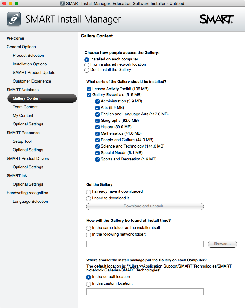

It's Smart Notebook. They have an official pkg builder that I've been using(to make sure it's easy to reproduce if I'm not around). This works great for installing and activating Notebook, but for some reason it cannot put the Gallery files in the same package. So they have you point the installer to a place where the files are located. The only two options are "Same folder" and "Network location", and attempts to just use "Network location" as a local file path haven't been successful. If the installer can't access the Gallery files, it continues on and just skips that part of the process. So it installs half of the program if it can't mount that share. Not end of the world, but less than ideal.

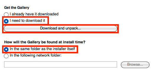

These are the options I see with the latest packaging tool:
When I last packaged SMART, I believe I selected "I need to download it", clicked the "Download and unpack..", followed by selecting the "In the same folder as the installer itself" options.

@bentoms That article glosses over the issue I'm having. It never actually goes into details on how to set up things. It just says "Customize the installer".
@daz_dar When you select "In the same folder as the installer itself", the installer expects to find the gallery files in the exact folder you run the installer from. If you push it with Casper, I believe that folder is /Library/Application Support/JAMF/Waiting Room. If the files are not in that folder like the installer expects, it will continue on with no visible difference and install Notebook successfully. You'll only find out it didn't install the Gallery files when you try to do something gallery related. You can check this quickly by opening the Gallery Setup app and seeing what options you have available.
