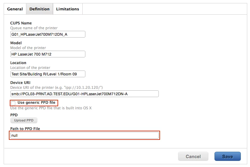

To completely fix this issue follow these steps:
Computer Management > Printers > Edit the printer > Definition (Tab) > Uncheck “Use generic PPD file” > type "null" in Path to PPD File > Save.

@Kumarasinghe - I went to Computer Management > Printers > Edit the printer > Definition (Tab) >
and noticed one of my 4 Sharp printers had 'use generic ppd file' checked but the PPD file was listed next to 'upload ppd'. Once I deselected 'use generic ppd file' and clicked 'save', the .ppd file for the printer was correctly listed in 'path to ppd file'
/Library/Printers/PPDs/Contents/Resources/YOURPRINTERNAME.ppd
