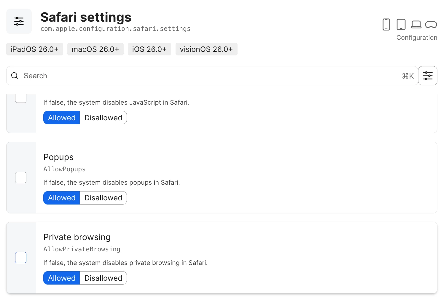

  • Sep 12, 2025 5:05 PM UTC
For those searching for an answer on this topic it looks like it will be an available Blueprint once the devices are on iPadOS26.  Will look forward to testing this out once we start updating.
