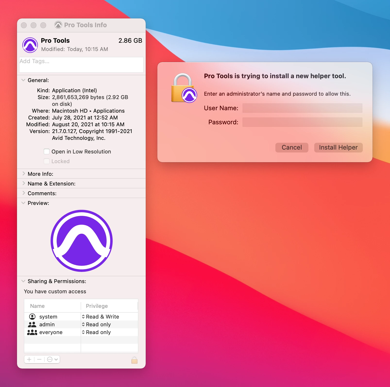

Hello everyone!
I'm hoping someone out there has a way to automate the installation of the helper tool that you get prompted to install when you launch Pro Tools 2021.7 for the first time? Pro Tools in this case is being installed using the PKG installer you download directly from Avid. Thanks in advance!
Best answer by rrouleau
I believe what you may be looking for are the com.avid.bsd.shoetoolv120 files.
I have had luck prior by creating a secondary package and installing it after the initial Protools installer (with restart enabled).

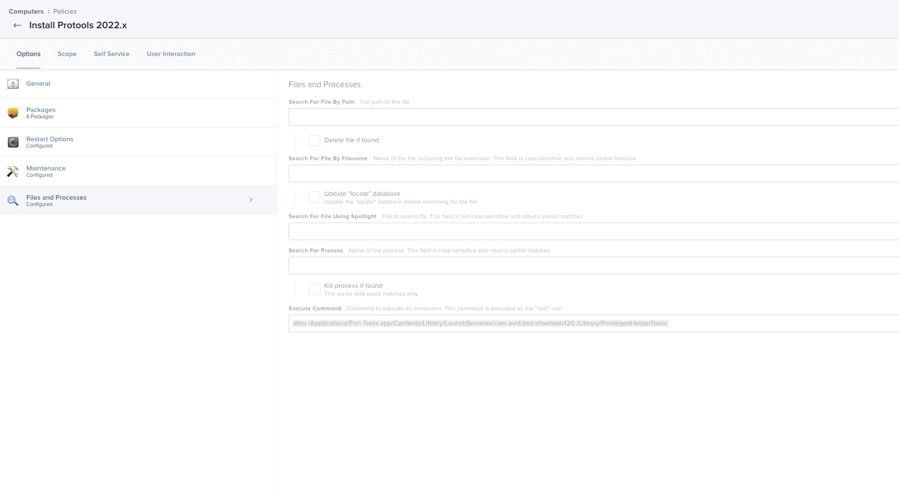

@bbarciz  I am no longer using a package to deploy the avid shoetool file.
I have now added a Files and Processes Execute Command to our Protools installer package to copy the file over (This works for our environment with PT 2022.7).
ditto /Applications/Pro\\ Tools.app/Contents/Library/LaunchServices/com.avid.bsd.shoetoolv120 /Library/PrivilegedHelperTools/
Screenshot Attached:
Thanks for the idea.  Do you not have to do anything with the plist file into the LaunchDaemons folder?
