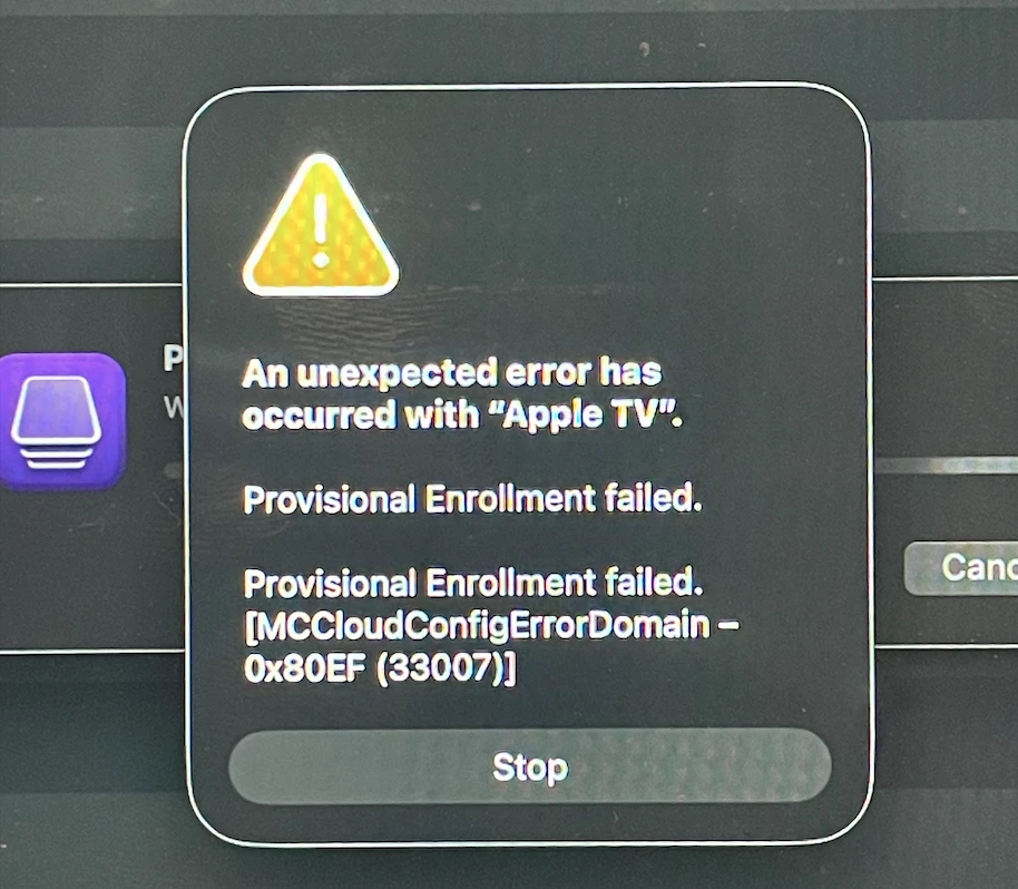

Hello everyone,
I’ve added many ATV to our School Manager with latest Apple Configurator 2 without any problem. But now I’ve run in to two problems. When click prepare it takes some seconds and then I get the error as bellow.
It’s a ATV 4 HD with USB-C. USB-C is connected to my computer and the computer and ATV is on the same network and the devices is updated to latest tvOS and reset. I’ve tried some times to set it in recovery mode but it just wont work. Does anyone have any idea what to do?

So just to confirm the Apple TV has an active, accessible internet connection. I assume it’s plugged into ethernet or you have a profile with a simple wpa2 or open network added to this blueprint? MCCloudConfigErrorDomain is typically either lack of connectivity or a certificate issue based on past experiences.
Ethernet connected and ATV and the computer is on the same network. I started the day with three ATVs - first failed, second worked fine and then the third failed as well.
