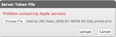

I am trying to set up DEP on our JSS and when ever I get to the point where I have to upload the server token file, I get the error "Problem contacting Apple services"
I've redownloaded the private key, deleted and recreated the Management server on Apple's side and tried again but always this error. Anyone got any idea why?
Best answer by Daikonbuu
With the help of JAMF support we just figured out the issue. The token was being denied by Apple due to the time on our server not being correct. We run our JSS on ubuntu so I had to set a NTP server, and force it to update the time. After this the token uploaded as it should.
Without JAMF support on this one I would have been at this for who knows how long.

@besteves, we had the same issue. Updating the date/time on the JSS resolved this problem for us.

This solution worked for me - server was 5 minutes out! Thanks!

In our case we solved it by installing Oracle Java on the JSS instead of open JDK.
With OpenJDK the JSS could not contact Apple Servers for DEP and VPP, after changing to Oracle Java, everything started working.

After a support call to JAMF Support and examining many support articles - we followed these steps to resolve:
  • Apple School Manager - "Get a new Token" from desired MDM Server
  • JAMF Pro - upload new "Server token file" Settings | Global Management | Device Enrollment Program
Once uploaded, errors went away and missing devices from ASM started populating in Pre-stage Enrolments.

Looks like this was our issue: https://macmule.com/2019/10/01/more-dep-sync-errors/
Sync is working after applying the fix.
