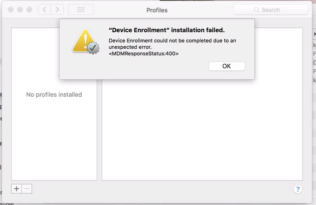

After editing and saving my prestages as suggested by JAMF Support, now getting the following error after invoking
sudo profiles renew -type enrollment
Selecting details, and accepting enrollment
