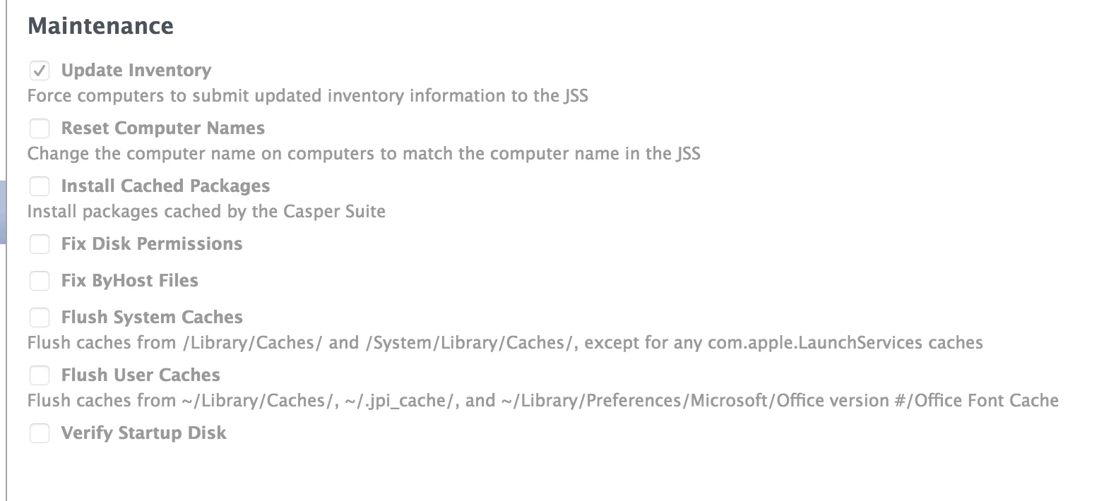

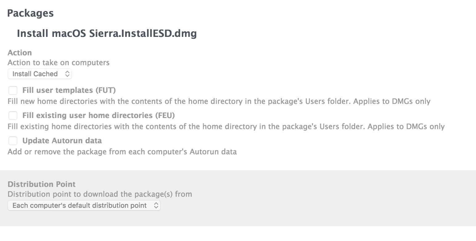

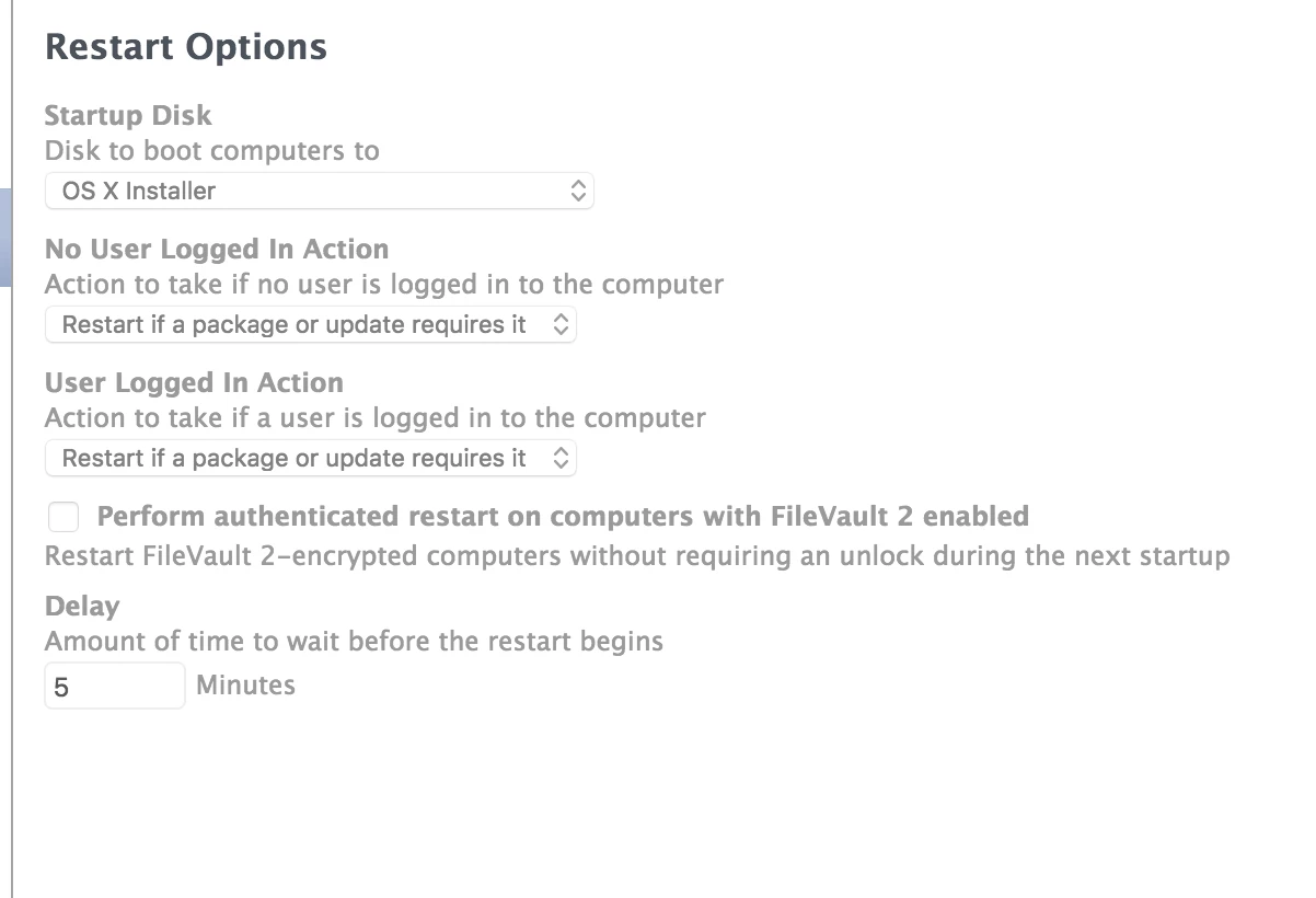

I'm having some trouble with our MacOS upgrade. I have my users installing a cached installer from Self Service, but when the machine restarts, it keeps restarting like normal and will not boot into the installation. The odd thing is, this only happens on some computers. I'd say about 25% of my machines are just restarting, and not installing MacOS, while the other 75% are restarting into the MacOS install screen. These are my current settings:
Does anyone have any idea whats going on? Are there any specific logs that I could be checking to see what gives? Thank you.

I usually set the "User Logged in Action" in Restart Options to "Restart", and subsequently set the delay to 1 minute. I also add in a blurb, if deployed via Self Service, to the user, that the machine will auto-restart in 1 min/60secs, just as a courtesy.
Also doesn't hurt to check the box for "Perform authenticated restart on computers with FileVault 2 enabled", just ensures that the machine boots to the installer, w/o having to authenticate...

I suspect that the immediate restart may have prevented the jamf binary from doing so, and that you need a 1 minute restart delay as @reelmike suggested.
  • October 25, 2016
@bradtchapman
I have it set to restart if package or update requires it. It is currently set to wait 5 minutes. I had it at 2, but was worried that the restart window was too short, and that was what could be messing up the install. However, there seems to be no difference in success rate with the 2 minute vs 5 minute restart time. The policy log is below. I should mention that it looks exactly the same for failed installs as it does for successful installs:

@jstine are the computers that the policy is failing on have FileVault turned on? If they do, have you tried enabling the "Perform authenticated restart on computers with FileVault 2 enabled" option?
