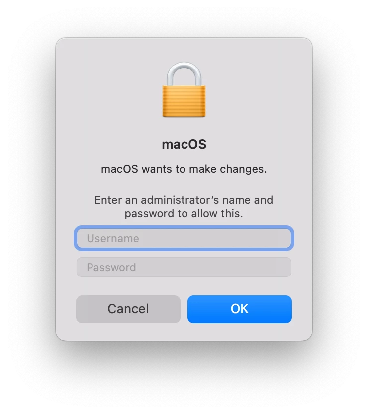

That's the screenshot of the dialogue box. I don't see any hints on what triggers the box.
The syslog corresponding to the timestamp of the screenshot shows something like this:
2022-05-05 14:35:58.535700+0200 localhost tccd[143]: [com.apple.TCC:access] -[TCCDPlatformMacOS evaluatePolicyForPromptingforService:byIdentity:attributionChain:]: policyResult = 3; isApplePlatformBinary = 1
There are multiple similar entries (~35), which only differ in the tccd#, which is sometimes 143 and sometimes 392.
For the Deny it looks similar:
2022-05-05 14:36:04.451595+0200 localhost tccd[392]: [com.apple.TCC:access] Platform binary prompting is 'Deny' because: is Platform Binary

Ok nice, that's not a TCC security prompt so we can rule that side out.

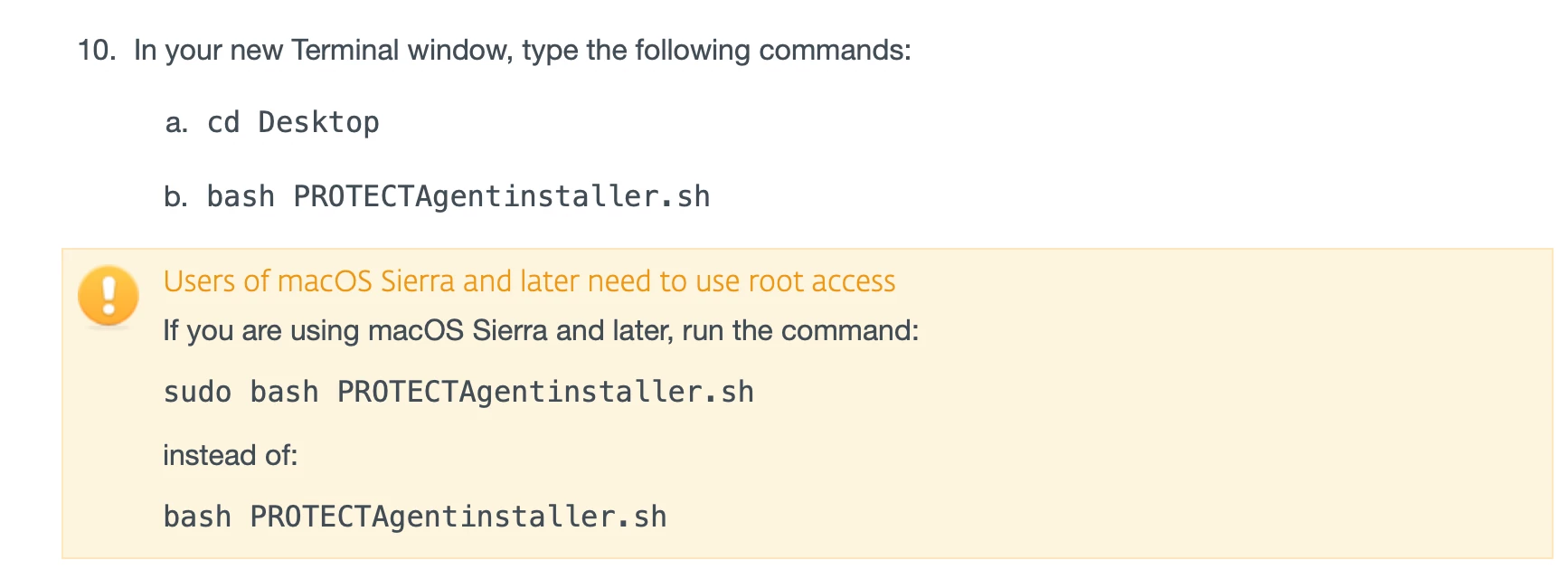

Software installer looks to be making system changes that require admin auth. Im not familiar with deploying this but looking at their scripts, there's a dmg, pkg, tmp dir, etc. etc. all would be run as root via Jamf Policy.
Sorry if you mentioned this but is this popup being triggered by someone manually installing part of this. I noticed there's a live installer extracted from a tar file which is documented, needs to be run as root and needing credentials.
Deploy ESET Management Agent to a macOS client
If it is you can add this into your Jamf workflow and it will be run as root. If this is occurring without user intervention then off to the logs to find out whats being touched.

No, it's completely done via Jamf, no manual interaction. That's why I'm wondering, it already should run as root.
