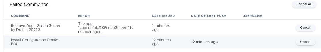

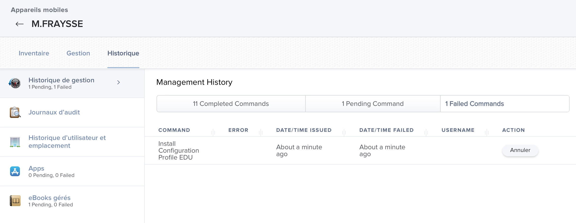

Hi
I have a iPad Pro 12,9 - 2018 with iPadOS 14.0.1
The Profile EDU fails to update.
I'm looking for a solution.
Thanks,
Matthieu

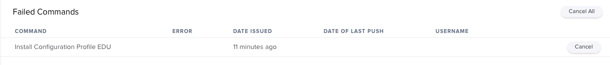

Hi @MFRA ,
I'm working on a customer with the same situation. I just completed setup of SFTP/ASM and enabled Jamf Pro Apple EDU Support, then tried to push the EDU profile out to devices but all came back with the same message as above. @vasko Any insight?
I also tried to remove all ASM synced classes and created a manually configured class and pushing that out to a test group, but this also failed.
HELP!
