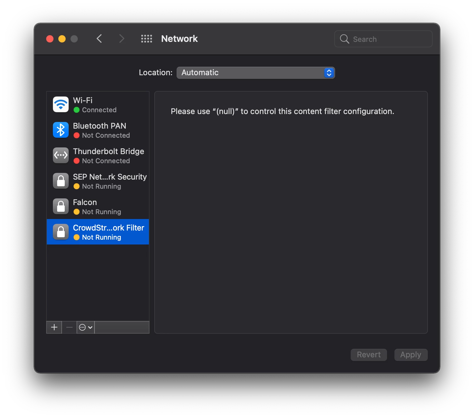

I have some config profiles for CrowdStrike and SEP. However, both are showing "null" in Network Preferences, and CrowdStrike installed it's own filter. I used all three options under System Extensions (Allowed Extensions, Allowed Extension Types, Allowed Team Identifiers). I did separate the System Extensions payload from the Privacy payload, so maybe there's a cross reference within the profile?
CrowdStrike's internally added network filter (after prompting):
The network filter from my profile:
