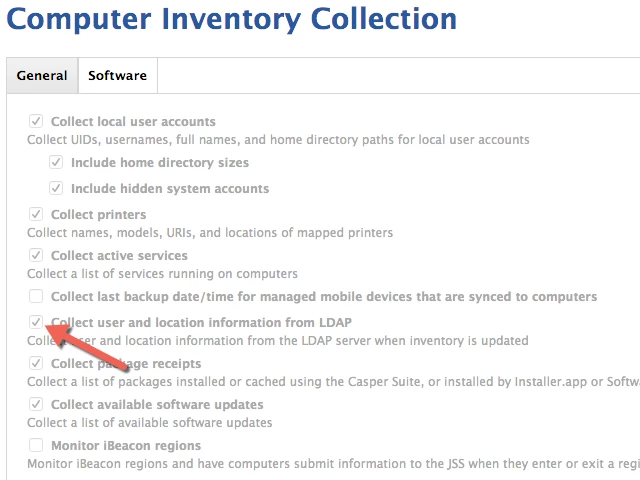

@Benjamin.Diehl yes it is possible. you need to go to your computer management settings make sure collect user and location info from LDAP is checked in computer inventory collection

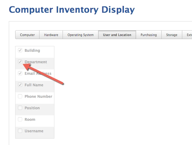

you also need to make sure in your computer inventory display settings that department is checked
