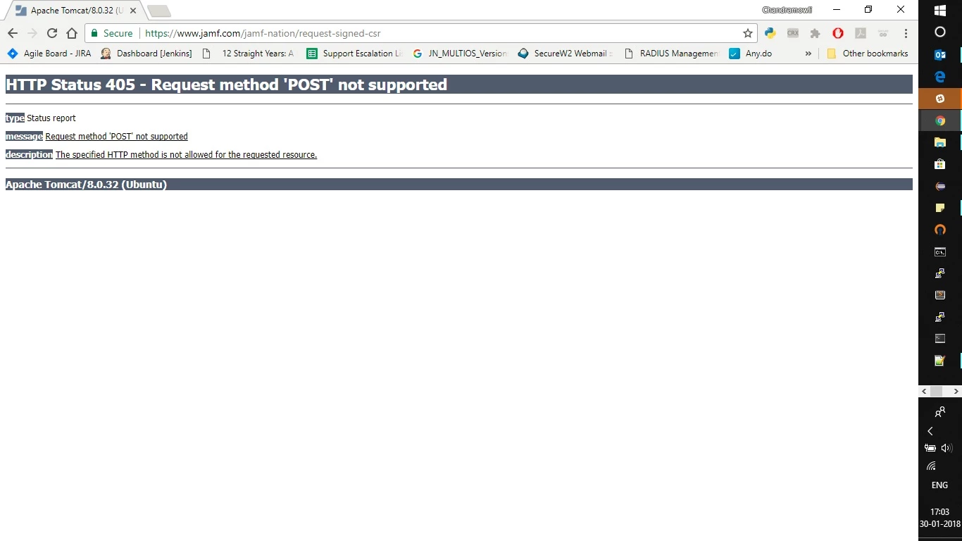

Hello support ,
I am unable to sign the CSR through the URL : https://www.jamf.com/jamf-nation/request-signed-csr.
I select the csr to be signed and then click on "Sign CSR" button and then it shows up 405 Error page. Screenshot attached.
Also, when I try the option to login to JAMF Nation using my credentials, for downloading the signed CSR, it says credentials are not validated and could not download the signed CSR. When I try to login to JAMF Nation in a separate tab , it worked. Wierd!!!!
Can you help me to get the signed CSR ?
