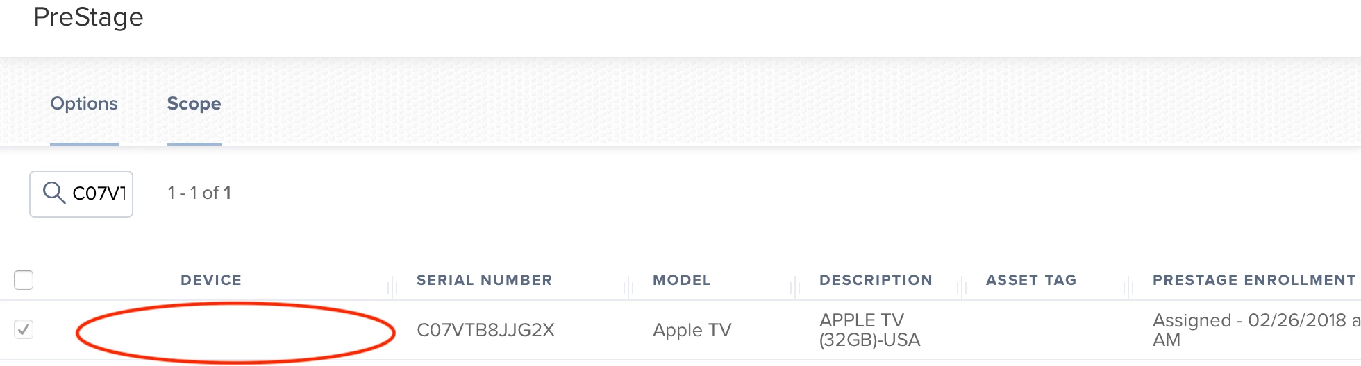

I have an Apple TV that is recognized in DEP and in a Pre-Stage but doesn't allow me to manage it (no clickable name that takes me to a management page and is not searchable). I'm trying to give it a specific name and to also force it into conference display mode. My guess is I've missed something really basic – any ideas?

It looks like the device hasn't finished enrolling, it just has the prestage assigned to it ready to go for enrollment. If you navigate to "Mobile Devices" and try to search for that devices serial number, does the device show up?
I've attached a picture showing my view when in the same page as you are (Prestage).
The top device is still waiting to be enrolled, whereas the bottom device has ran through the DEP enrollment process and can be managed now.
  • April 3, 2018
The image pictured above is the exact serial I'm looking to manage (so it shows up in the list but not with a link). I've been through the setup screen on the actual Apple TV and can navigate through apps etc, so I figured I might have missed something but everything looks correct.
  • April 3, 2018
@bananapatata Sorry, I should have clarified, I was asking if you navigate to "Mobile Devices" (Might be Devices, if you are on Jamf 10 or higher), then click on "Search Inventory", and search for the serial number there, does the device show up? Your picture is from the prestage page, which shows every device in your DEP environment even if they are not currently enrolled in your Jamf environment.
