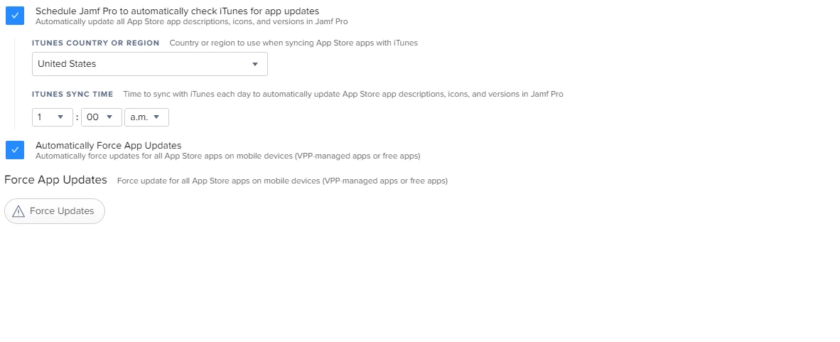

Is there any way with JAMF to schedule when iOS apps update themselves so that they're not trying to update willy nilly throughout the day? We have some users who are complaining that their apps try to update at inopportune times. Force updates are set on, but it's my understanding that if we didn't have that then they'd have to manually update their apps via self-service? Ideally I'd want to set it to just run updates overnight if that is a possibility in JAMF Pro.
Any help is appreciated. Thanks!
13 replies
Forum|alt.badge.img+15
  • Jun 17, 2019 3:31 PM UTC
Go to Settings -> Device Management -> App Maintenance. Check the box next to "Schedule Jamf Pro to automatically check iTunes for app updates," set your ITUNES SYNC TIME (we have ours set to 1:00 AM), and check the box next to "Automatically Force App Updates." That should do it for you!
~Joe
