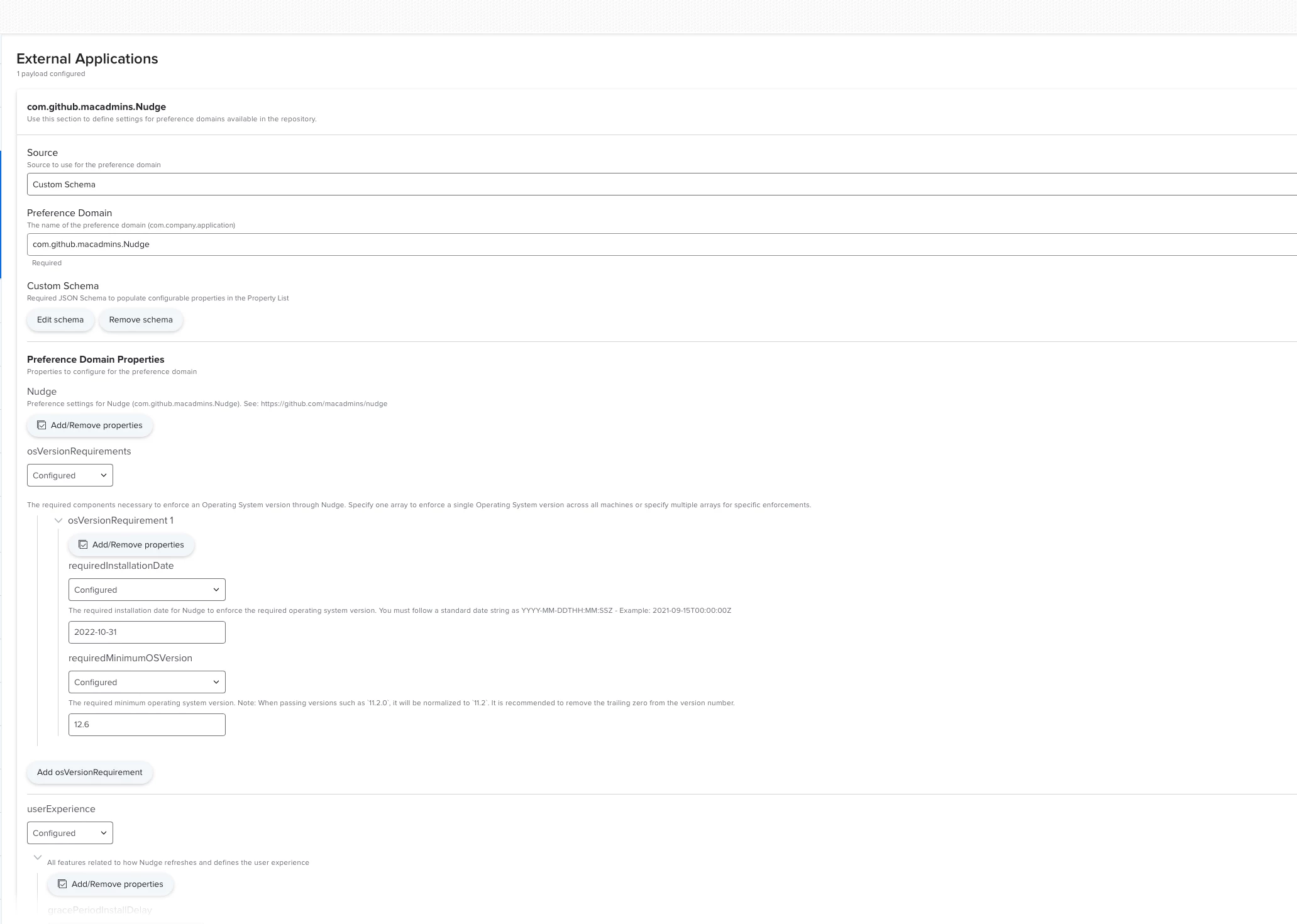

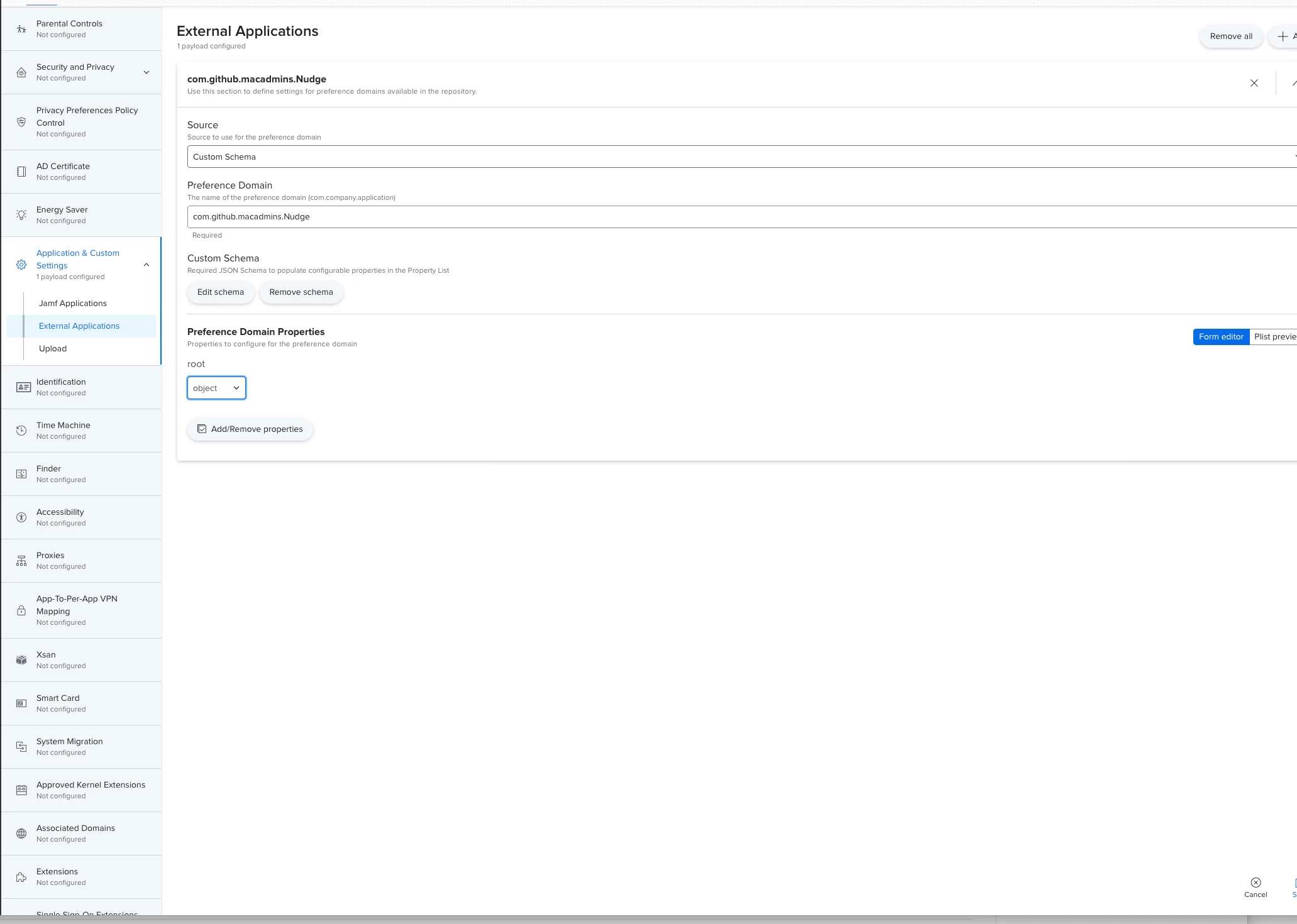

I'm trying to get Nudge working with a JSON file but based on this older post:https://community.jamf.com/t5/jamf-pro/having-issues-uploading-a-config-profile-for-nudge/m-p/246960#M231095
My JSON configuration profile doesn't look the same. My understanding is that it should say Nudge and allow me to modify osVersion Requirements, userExperience,etc
Also if I use a JSON I don't also need a separate mobile config is that correct?

The JSON becomes the profile and it presents the keys - are you able to select  Add/Remove properties? if not there may be an error in the copy of the JSON - if you get it from here - https://github.com/macadmins/nudge/blob/main/Schema/jamf/com.github.macadmins.Nudge.json and then hit the copy raw and paste it into the "edit schema" section it should essentially be blank in for form and then you Add/Remove sections.
  • October 17, 2022
Thanks! That worked. Does this take the place of a Launch agent for timing? I want to have Nudge reminder users twice per day. Settings via the JSON below.
