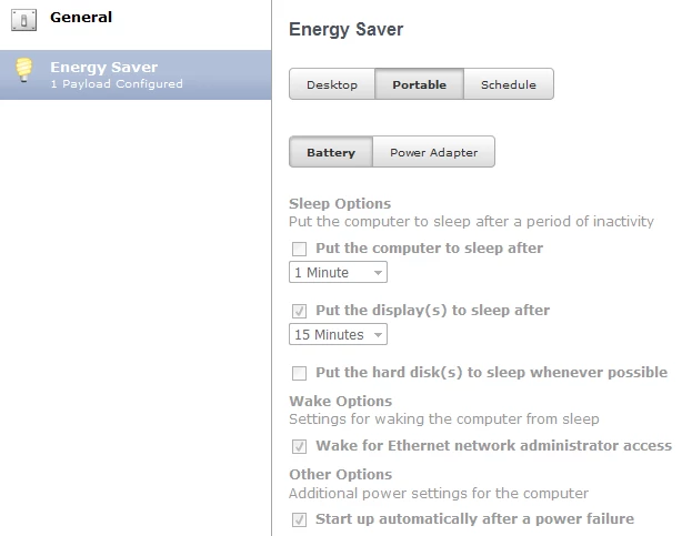

Hmm, I'm not able to find anything on the "logout after x minutes of inactivity". I checked on my computer and my profiles in the JSS and don't have the settings set for the computer to sleep. I attached my settings for the Energy Saver profile which is the same for each option. The schedule isn't set up to do anything.
Do you have suggestions on where to look for any other setting that may be related to this?

@jpilege Check "Login Window" payload -> Options for the "log out users after x minutes activity"
When we upgraded from 9.73 -> 9.81 we were having issues with this. Ended up having to delete the profiles with login window payloads and recreate to get rid of the auto log out behavior.
  • February 22, 2016
Thanks @merps!
I found the setting under my profile and it was checked and set to every 30 minutes. I must have just read over it. :/ I remember not having this checked, but I'm wondering if the setting changed from the JSS updates over time. It looks to be a default value when I go to created a new profile. I won't know how things go until another 30 minutes go by, but I believe this was the fix.
