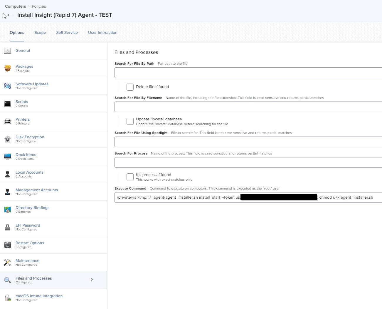

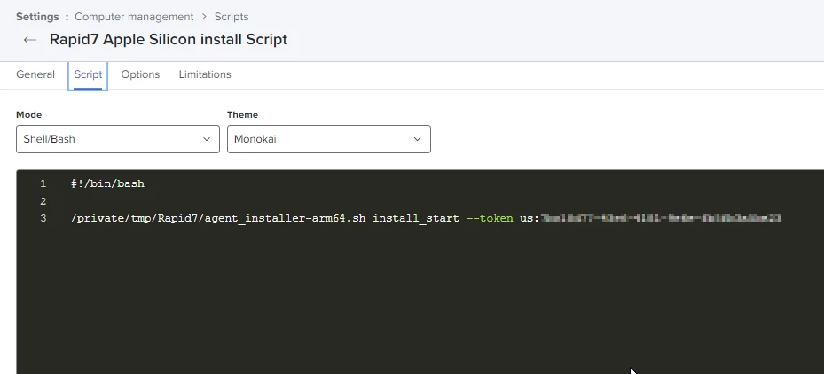

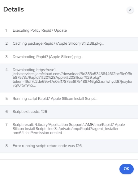

  • Feb 23, 2023 8:58 PM UTC
Hello,
We have about 40% of our devices not getting the Rapid7 portion of our enrollment for whatever reason.  These devices are about 30% intel, 70% carbon chipsets.  I have dinked around with a handful of scripts but the screenshot I uploaded is the original script that has successfully worked on a little over half of our devices.  I went in and edited to some of the information above as in including the chmod and sudo portions mentioned by PCSysops but logs returned 'Failed' results as well, although they didn't return a permissions issue, they returned a "File not found" error instead.
Does this look familiar to anyone?  Any advice is greatly appreciated.

  • Mar 7, 2023 7:46 PM UTC
Hello,
Kerry
Be sure to change permissions in the install script.
Ex.
chmod u+x /private/tmp/Rapid7/agent_installer-arm64.sh
/private/tmp/Rapid7/agent_installer-arm64.sh install_start --token us:Your Token Goes Here
rm -rf /private/tmp/Rapid7

  • Apr 4, 2023 8:51 AM UTC
Hello,
Kerry
Hey @kprimm
Did you run the chmod command prior the script executing?
