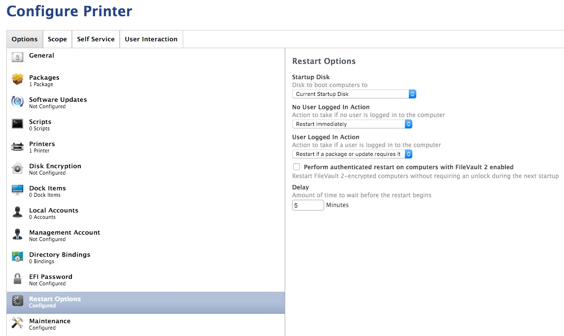

  • February 25, 2016
Fixed!, turned out that not all of the policies had the restart option @ no user logged in action set to restart immediately.
  • February 25, 2016
@rschenk Can you elaborate on that, or provide a screenshot of your working policies for Enrollment Complete trigger? We're hitting the same issue.
I have mine set to trigger on enrollment complete, frequency ongoing, and also allow the user to trigger via Self Services since they are failing.
  • February 26, 2016
Here is an example of our Printer policy that runs after enrollment. I've set the reboot option @ No User Logged In Action to Restart immediately. This is the same for my other Enrollment Policies and it works for me.
