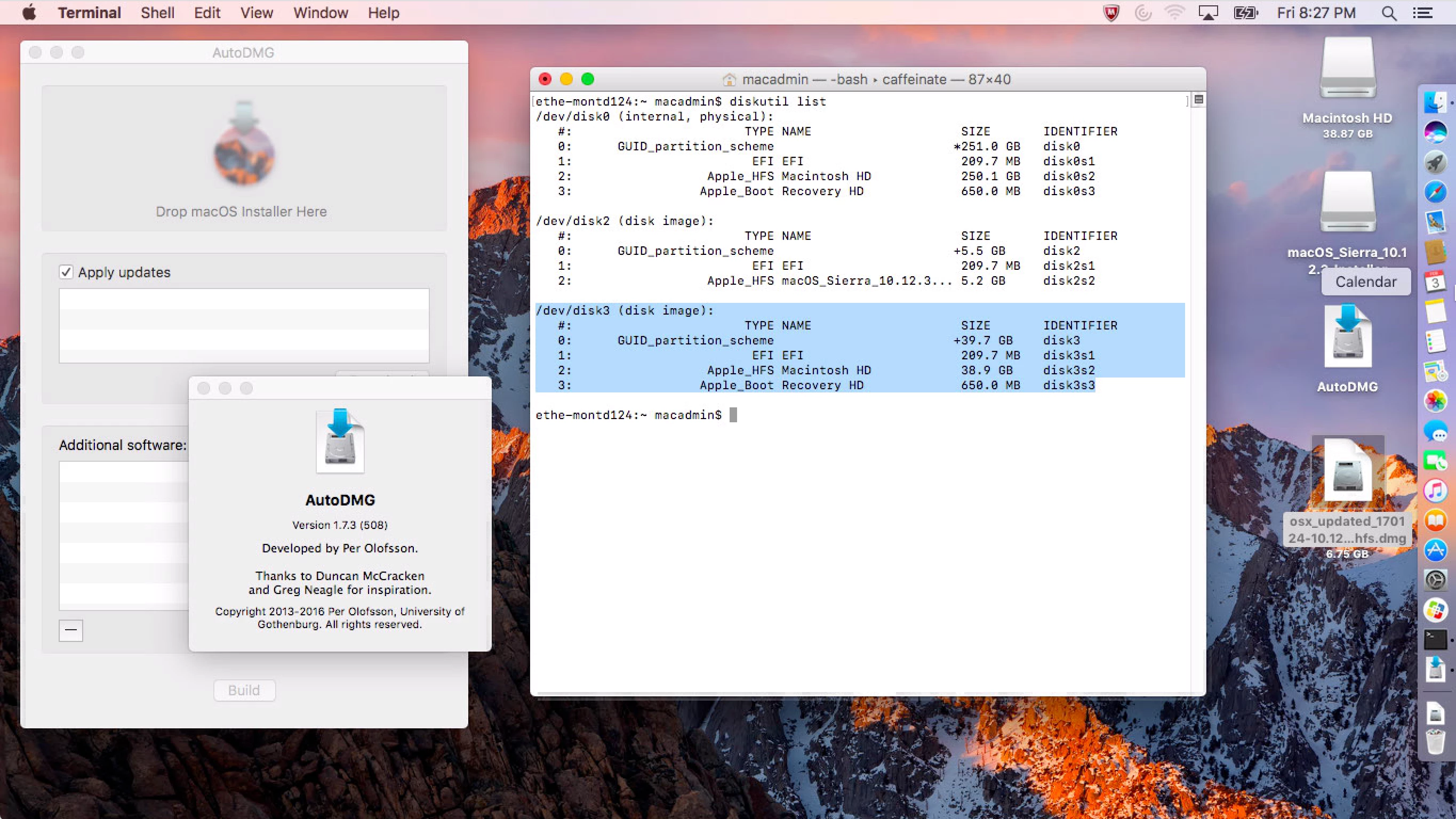

Here's how the image looks when mounted, using diskutil list, note /dev/disk3 has both partitions, this was for Sierra. Performed the same test on El Capitan with same results. Both the Sierra and El Capitan LAB computers booted into Recovery HD without a problem.
