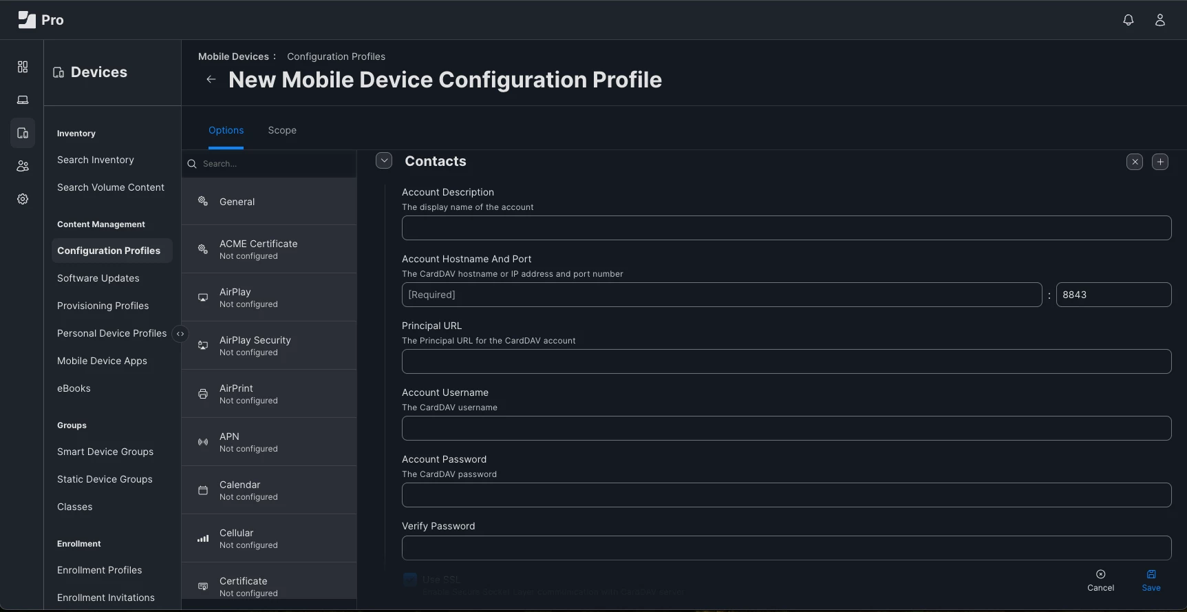

Hi @tholder. Could you help me understand what to put for the fields to connect my contact configuration profile?
1. Account Hostname and Port
2. Principal URL
3. Account Username
4. Account Password
  • Mar 10, 2025 10:42 PM UTC
2. Principal URL
3. Account Username
4. Account Password
I saw this link: https://faq.contactzilla.com/article/55-how-do-i-sync-contacts-with-my-iphone-or-ipad but it doesn't sharing anything about principal URL or port.
tholder
  • Mar 10, 2025 11:21 PM UTC
2. Principal URL
3. Account Username
4. Account Password
Easiest approach is to go in to contactzilla and download a provisioning profile, you can then open that in a text editor and it will contain all the details. Are you using contactzilla v1 or v2? Feel free to ping our support an email with details of your account and we can take a look.
