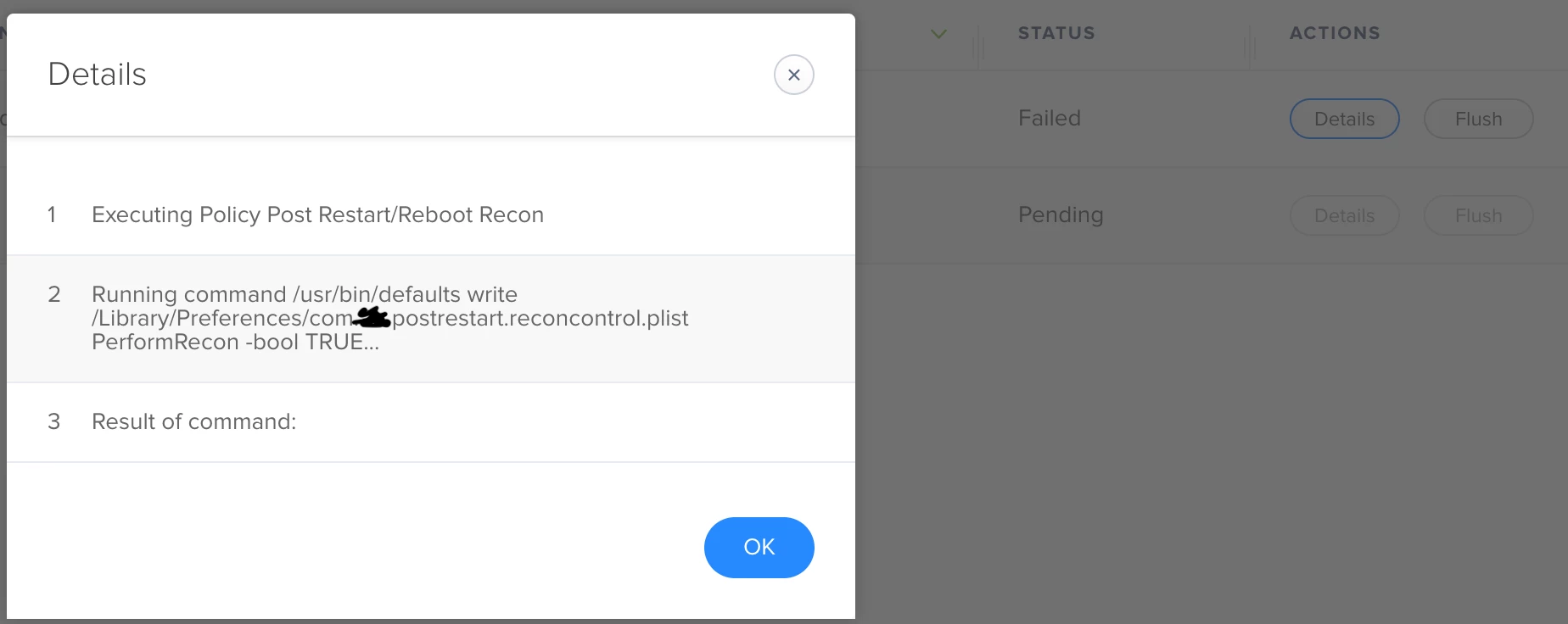

It seems to be working with the test machines, but just shows Failed in the logs - would that be normal?

Ok, so let me make sure I understand. What's showing as Failed is the command to flip the plist setting to "TRUE" to enable a post reboot recon? If so, that's odd. Is the Execute Command the only item in that policy or do you have other items executing in it as well? From the log you posted it looks like it's the only item in it, but I just wanted to be sure.
What trigger is running that policy? Check-in, or something else?
I don't see anything in the log that indicates a failure, other than the fact that it says "Failed" in the log status window in the background. I'll have to run some more tests, but off the top of my head, I don't see a reason why it would be registering as failed.

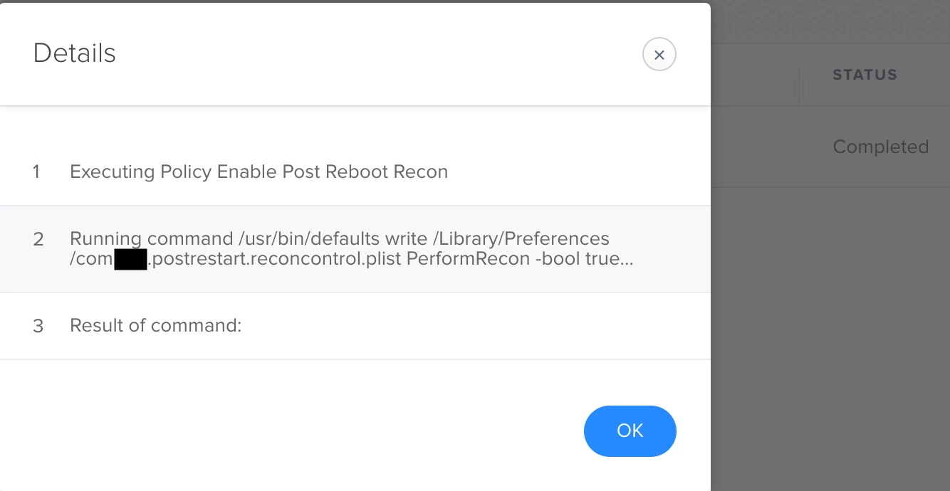

@raphhyyy Quick follow up.
Set up two new policies. One to deploy the script that creates the LaunchDaemon, local script and plist file. I let it run on a 10.14.6 Mac by the check-in trigger. I let it run on it's own, so meaning the Jamf LaunchDaemon triggered it, not me in Terminal. No issues. It created all the files and plists as designed.
Second policy was created to flip the setting in the local plist file to true. Also set up using the check-in trigger and allowed to run naturally, on the same Mac. No issues. Here is the policy log for that, which essentially matches that of what you posted above, minus the customization of the plist name of course.
The only other difference is my command used true, and not TRUE I think both should work, and I will test that to see, but just in case, try using lowercase. Maybe it doesn't like the uppercase TRUE in the command?
Other than that one possibility, I don't have an explanation on why you'd be seeing those failures. I would check any other payloads (if there are any) in the policy to see if something else may be causing it. Or check to see how it's being triggered, when and so on. Maybe something else is affecting it. Without any more detail in the log on why it's seeing it as a failure, its pretty hard to troubleshoot.
