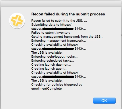

Hi All,
We are having problems with reconning systems with casper at the moment. When we attempt to recon from a system using the "sudo jamf recon" command in terminal we get a result saying "There was an error. Message has no content"
Casper shows that the system checked in, but did not update inventory.
When we use the Recon App we are also seeing an error - I have attached a screen shot of the message.
We are using Casper 9.61 and our system displaying the fault are a split between Mac OS X 10.9.5 and Mac OS X 10.10.0
Any help would be greatly appreciated.

Hi @chriscollins
The following is what we see when a recon is attempted via terminal;
Retrieving inventory preferences from https://casper.myserver.com:8443/... Finding extension attributes... Locating accounts... Locating applications... Locating package receipts... Searching path: /Applications Locating hard drive information... Locating printers... Locating hardware information (Mac OS X 10.10.3)... Gathering application usage information... Submitting data to https://casper.myserver.com:8443/... There was an error. Message has no content
