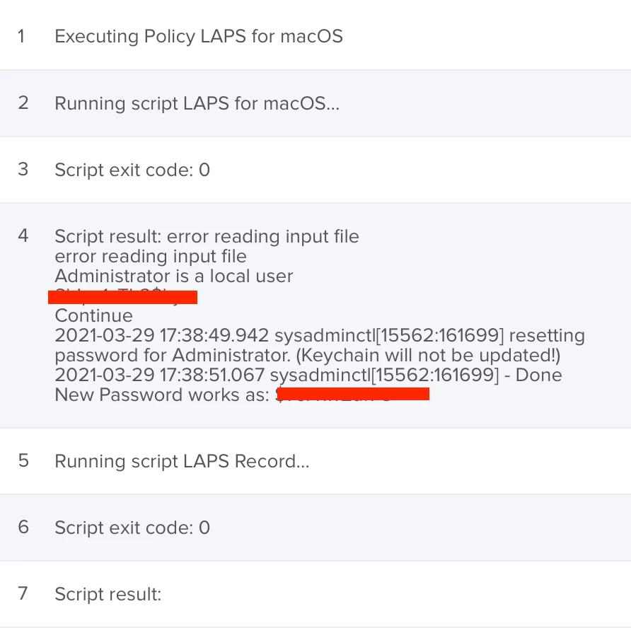

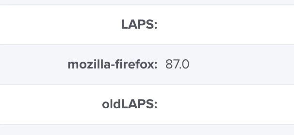

I am having trouble with recording the LAPS for macOS passwords to the LAPS EA. Everything works and there is no error, yet the LAPS EA is blank every time. I can see the password if I look at log details so I know the rest of the process works pretty flawlessly. Here is the script I am using:
!/bin/bash
apiUser=""
apiPass=""
apiURL=$(/usr/bin/defaults read /Library/Preferences/com.jamfsoftware.jamf.plist jss_url | sed 's|/$||')
udid=$(/usr/sbin/system_profiler SPHardwareDataType | /usr/bin/awk '/Hardware UUID:/ { print $3 }')
extAttName=""LAPS""
LAPS_Password=$(curl -s -f -u $apiUser:$apiPass -H "Accept: application/xml" $apiURL/JSSResource/computers/udid/$udid/subset/extension_attributes | xpath -e "//extension_attribute[name=$extAttName]" 2>&1 | awk -F'<value>|</value>' '{print $2}' | tail -n +1)
echo $LAPS_Password
I hardcoded the api username and api password to the script.
Here are screenshots of the resulting log and the EA

You need to return/echo the variable wrapped in result tags
echo "<result>$LAPS_Password</result>"
You may need/want to wrap the variable in curly-braces if spaces were present for expansion
echo "<result>${LAPS_Password}</result>"
This article can speak more to it for you...
Creating Extension Attributes Populated by a Custom Script

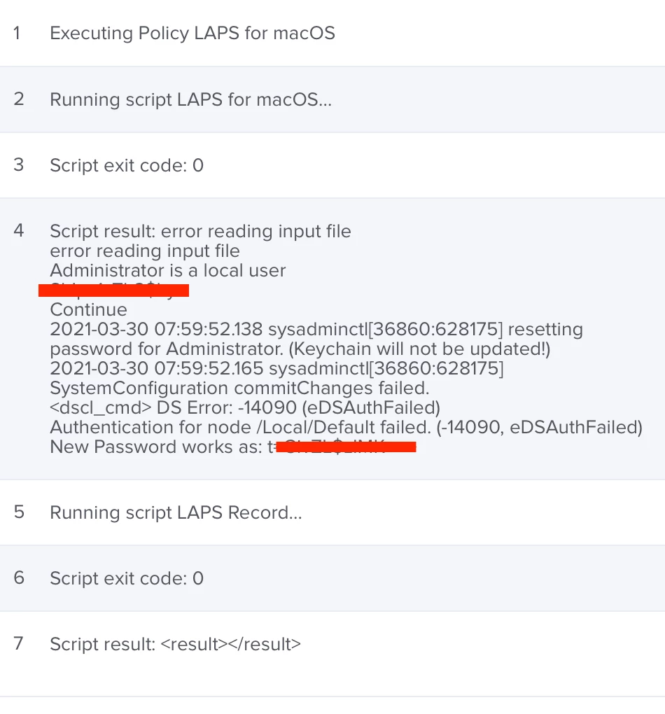

@dkmansion Hmmm... Still not working. Now I get this return in the logs:
