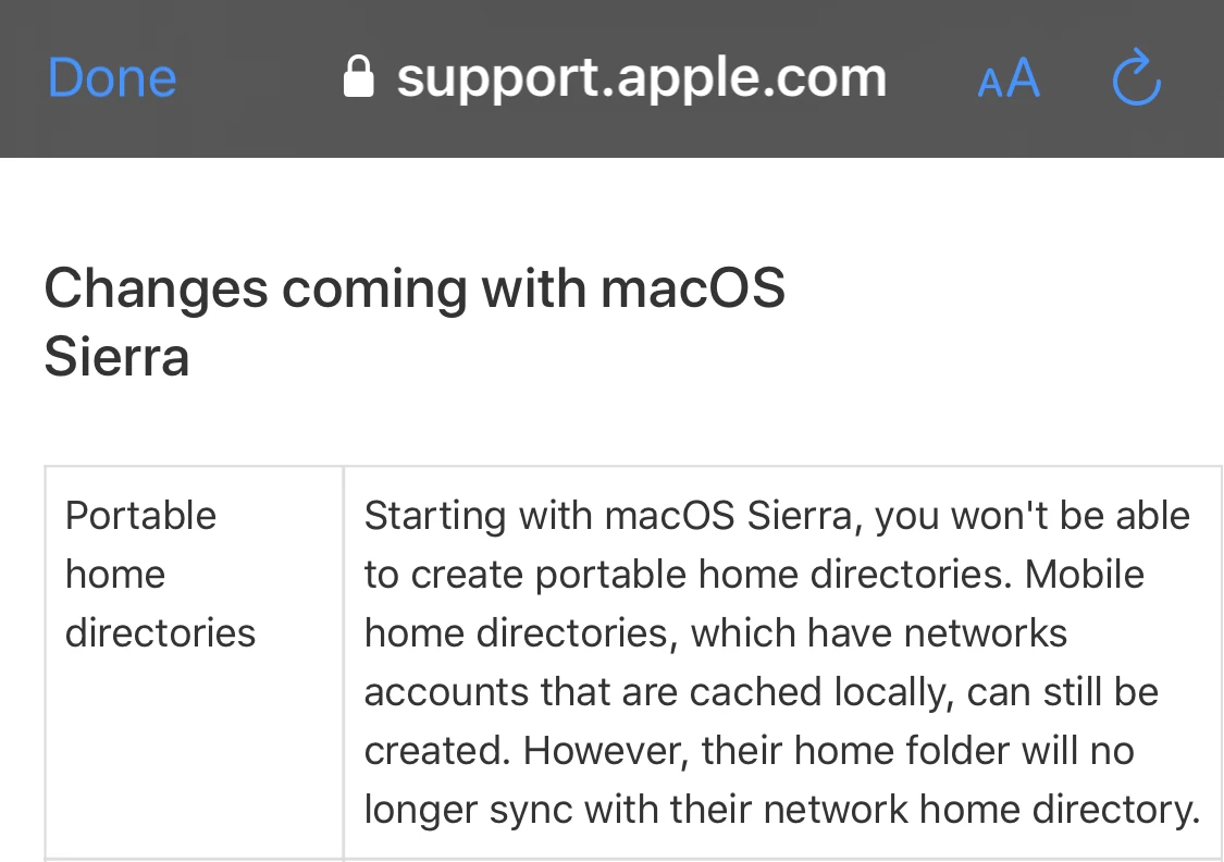

From 2018, I wouldn't even try. It's not a function of the OS, while it talks about mobile, they hardly worked.. Many hours of pain back in the day
